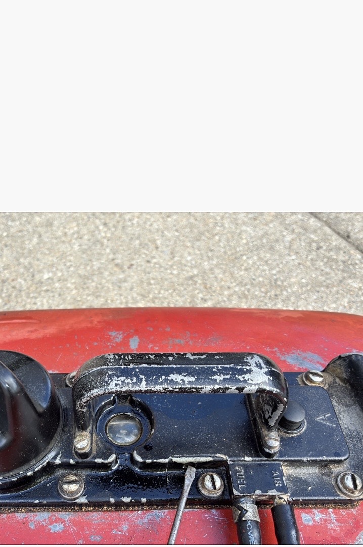

Then what is this hole for ?
I just went out to the shop and looked at two tanks, both have the hole in that spot. I took a piece of wire and inserted it and it is a blind hole about an inch in, not sure if the hole turns 90 degrees or not. My guess is that it may be an air bleed hole on the non pressurized side of the pump diaphragm to allow it to undulate during the priming function. If you have fuel coming out of it, the diaphragm may be bad. That's my educated guess. As Racer would say, "some may argue".

I would take it apart again to gain understanding of why you have fuel coming out of that hole. There's a breech in the diaphragm or some other leak mechanism that's keeping it from priming correctly and loosing pressure.

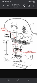

Here You go, brother.
It's hard to believe but I have many many of these tanks that are still original and have never been rebuilt that work perfectly absolutely perfectly beautiful engineering. Their worst enemy is ethanol fuel.
