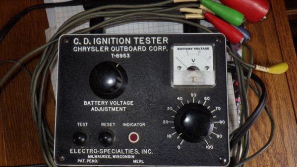

If ya' know, does this work for testing those units?
That's for the older Chrysler Motors.
Electro is still in business.
They might have instructions?
I saw this being bused by the lead mechanic back when I started on boats in 1986
I never used one.
