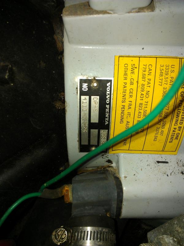

2- I did identify a data plate on the transom. A picture is provided for clarity. I did find several numbers on this data plate.
Can someone:
a- clear/confirm what exactly these numbers are (engine/drive serial/model #'s??)

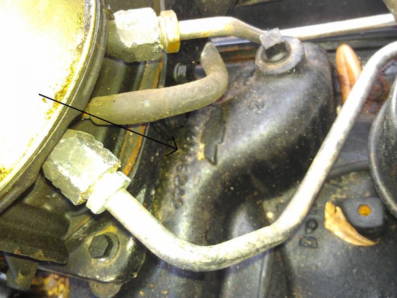

3- also located a raised number (forged) on the top of the intake manifold next to a Chevy symbol. See picture. Does this mean anything?
