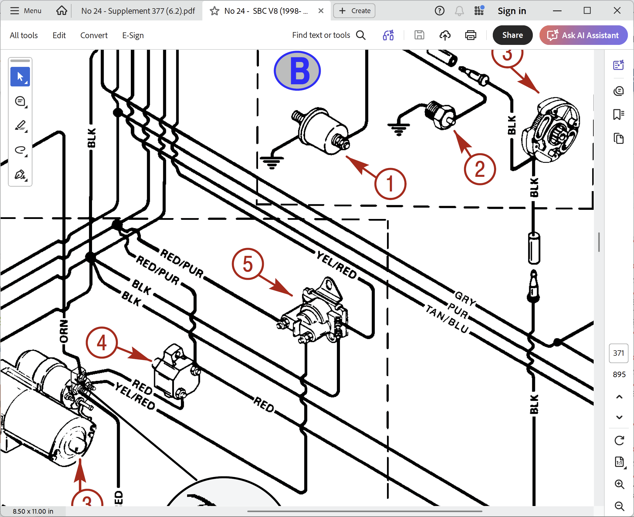

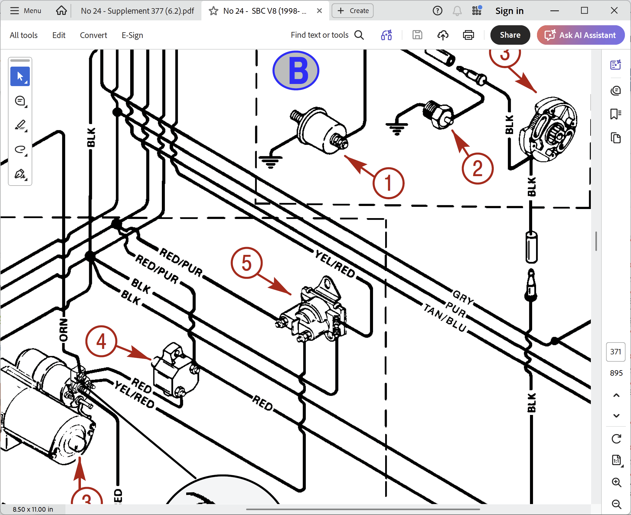

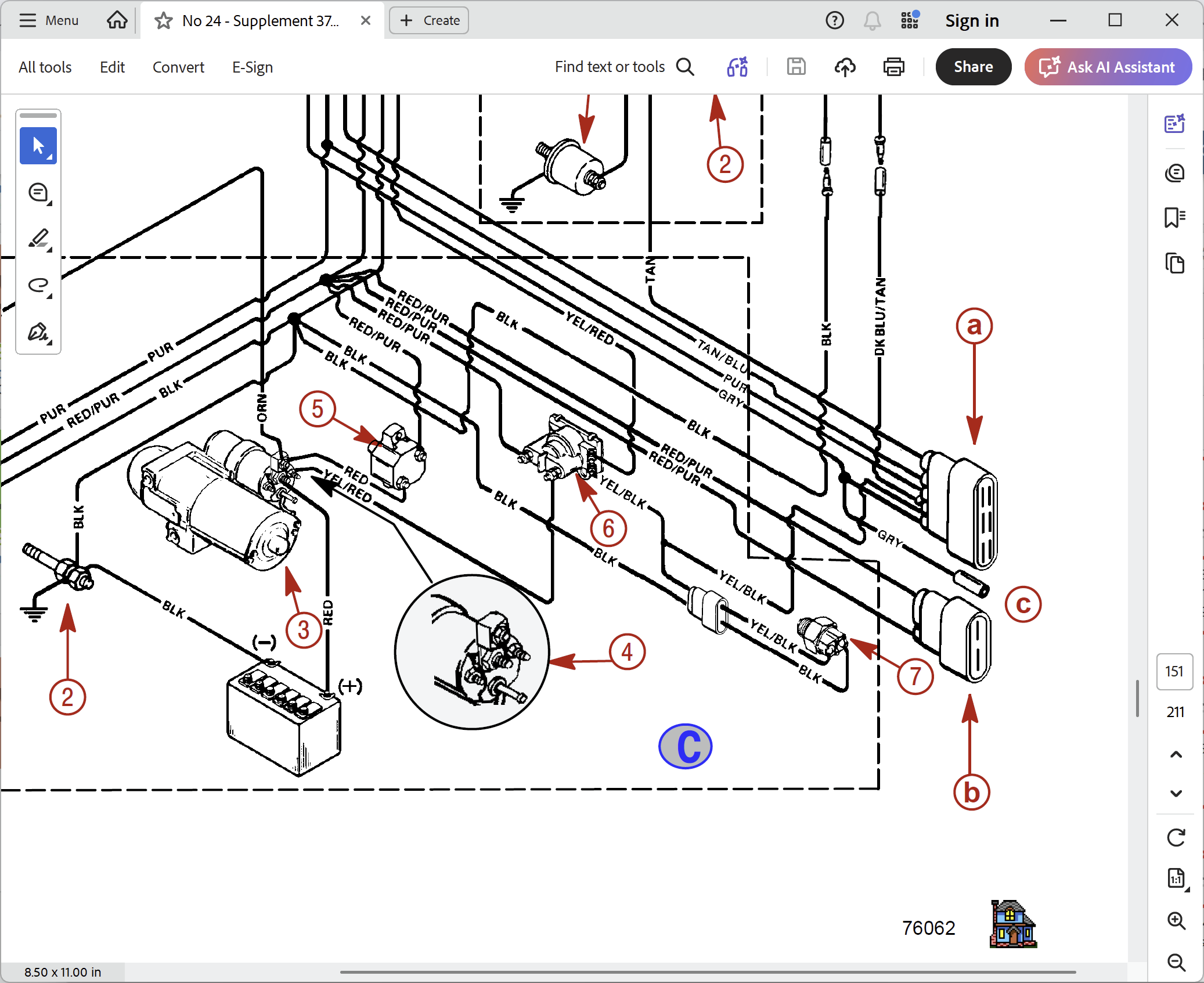

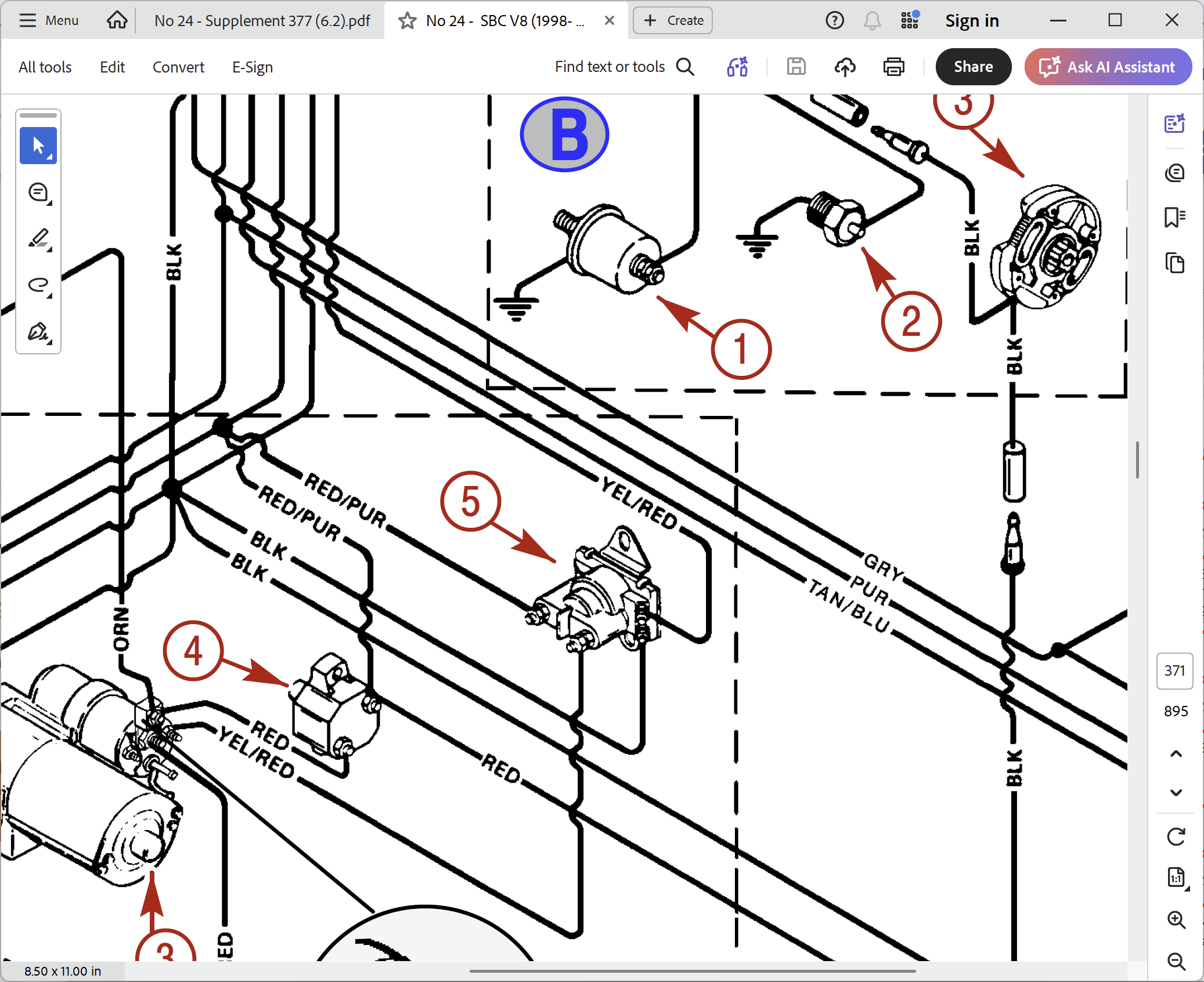

I have a 2006 centurion Enzo with the 5.7l black scorpion. Bought last week. Test drive went great, get it home and have intermittent starting issues immediately. Starter seemed to have a dead spot, put in a new starter, no change. Put in new slave relay, no change. Removed engine ground, cleaned everything up and put back together, no change. I seem to be getting correct voltage readings everywhere I check. What’s next? Is the new MercCruiser starter bad? I feel like I’m chasing ghosts.

Need a helper, but when it's not cranking check power on the small Yellow/Red wire on slave solenoid. Might also be a bad connection
