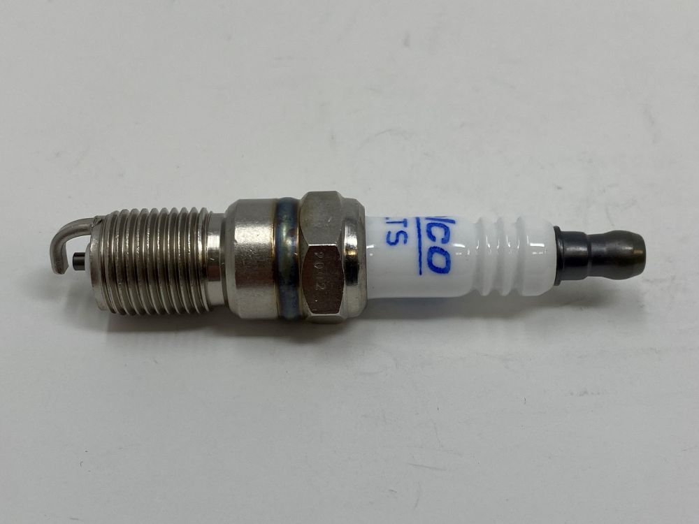

My YC had one of its boats ( 24 ft Privateer inboard) "re-engined" last spring ( May 2021 commissioning). The boat was used during the season for about 100 hours. It was winterized by a different yard than the one that did the engine swap.
Several days ago the yard that winterized the engine, recommissioned the boat. Their report was 150 psi in one cylinder, 0 in another. Cylinders #2 and 4 involved. The engine has a full "fresh water" cooling system. The yard that did the swap claims "bad winterizing".
I think the engine was shot at install. See pix of removed plugs... and no, I don't know which plug or cylinder is which. Any ideas how this kind of damage could happen in one season on a FWC engine... BTW... no record or indication of coolant loss.
Note condition of center electrode in lower plug.
