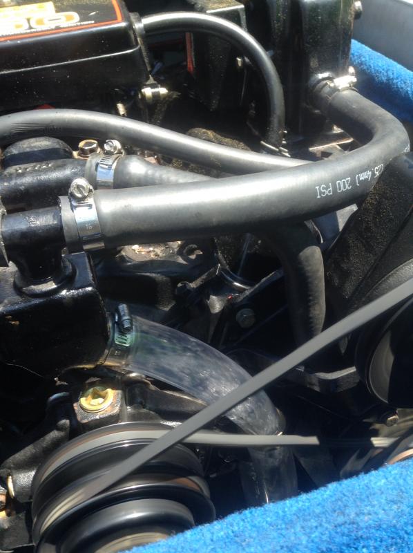

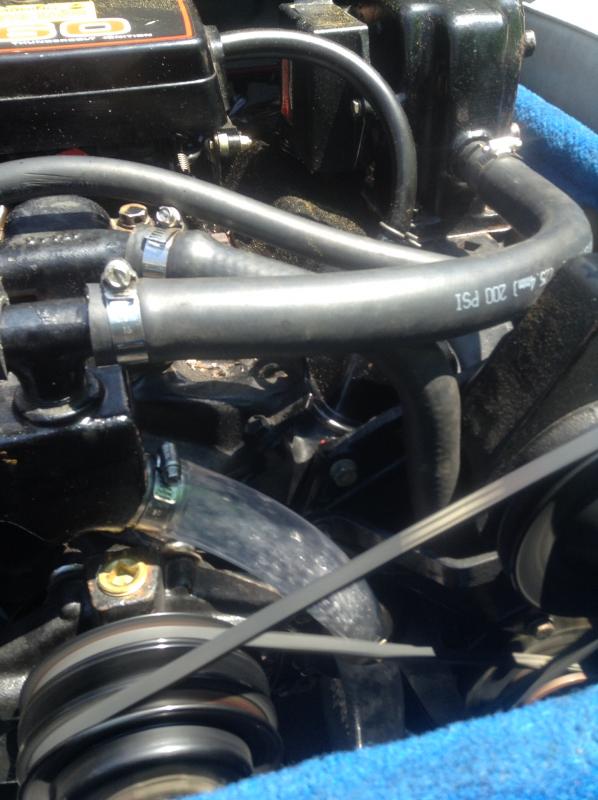

Greetings! FINALLY made it to the lake with a length of 1.25 I.D. clear tubing that I ran from the power steering cooler to the thermostat housing. Obviously the issue is not obstruction but bubbles. I asked the wife to take a video with the Ipad but unfortunately, only got a photo. To summarize, at idle, no bubbles, at plane speed, (sorry, tach is broken) guessing 2000-2500 RPM, the bubbles are fast and furious. I didn't bother increasing throttle to he point tat the temp rose to hot, it thing the cause of the high RPM overheat has been discovered - now on to finding and repairing the root cause! Asking for help with a starting point and any diagnostic techniques or tricks of the trade that anyone can offer. Perhaps waste of $$, but I will replace the complete water pump and confirm / double check the gaskets and seals - Discharge tube seal / o-ring - copper water tube, pocket and gaskets - O-ring between upper drive and bell housing. My earlier attempts included a "pressure test" of the hose from the bell housing to the transom - didn't see any leaks. So, that's the plan - Any suggestions, ideas etc are sincerely appreciated!
Water pump is drawing in air. Probably just a bad water pump gasket.
