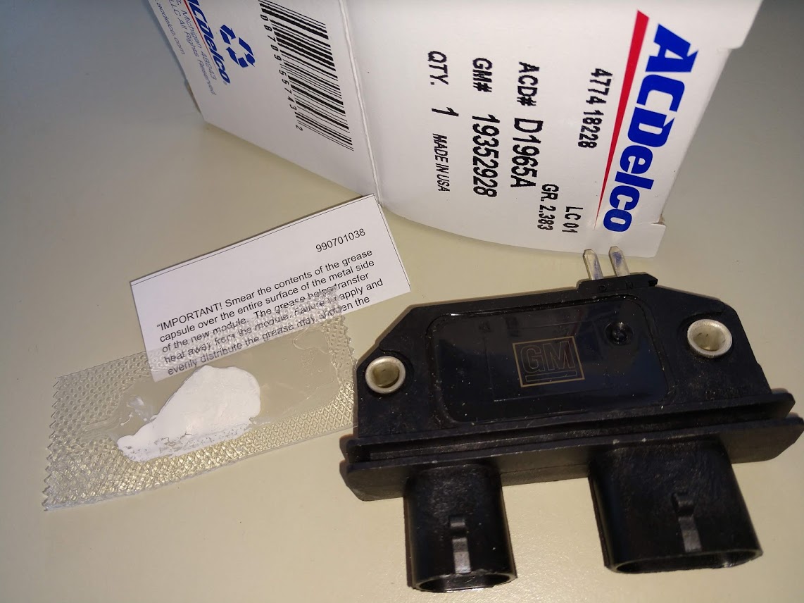

You replaced your distributor. What distributor did you install? I'm asking that because I swapped my distributor with a Voyager EST type replacement, and not long after I started having backfire through the carb on acceleration and sluggishness at higher RPM. I found that the module inside the distributor was no longer providing the progressive timing advance that it should have. I then bought a cheap replacement module, and after a short period of time, it too was not advancing. After a lot of Googling, I found that people are having success with the AC Delco module, which would have been used in a genuine OEM Delco Voyager distributor. I've had no trouble since I replaced the module.
So, regardless of the distributor manufacturer, my advice is to check your progressive timing advance. I was getting only about 16 degrees of advance (as I recall) from 1800 RPM and up.
If you do have the Voyager EST type distributor, the AC Delco module part number I'm using is D1965A.
