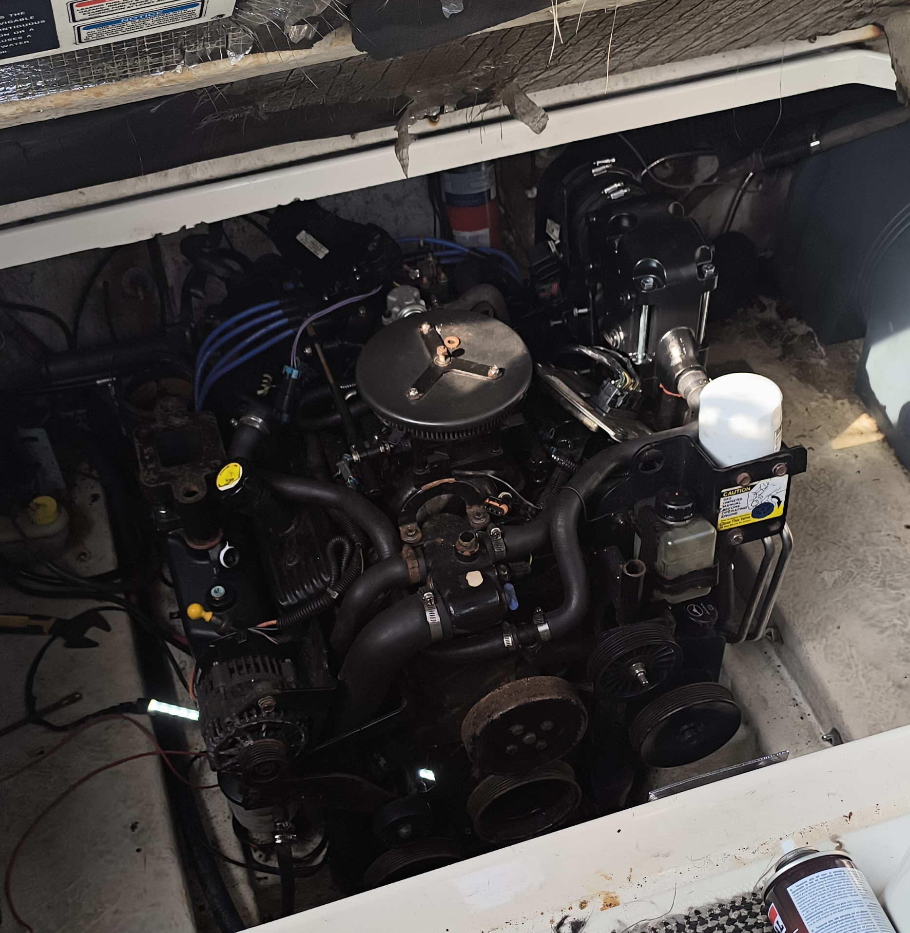

Friend was out on his boat. Only just put new manifolds and risers on. All gaskets right and the flow restriction gasket in the right place. He was at idle for 15 mins and engine temp was 140ish on the gauge but he said the manifolds were really hot and the risers cold. I'm going out tomorrow with my laser thermometer but wanted to get an idea about the expected temps. It's a raw water cooler one.

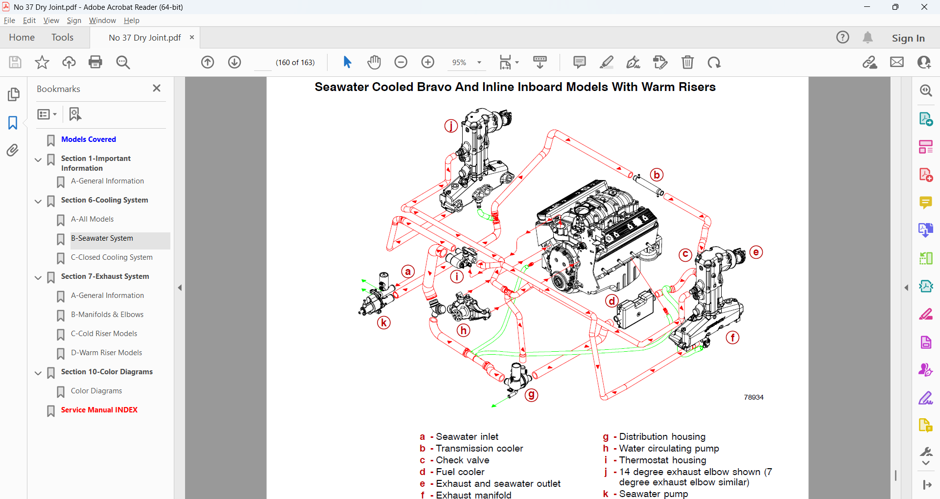

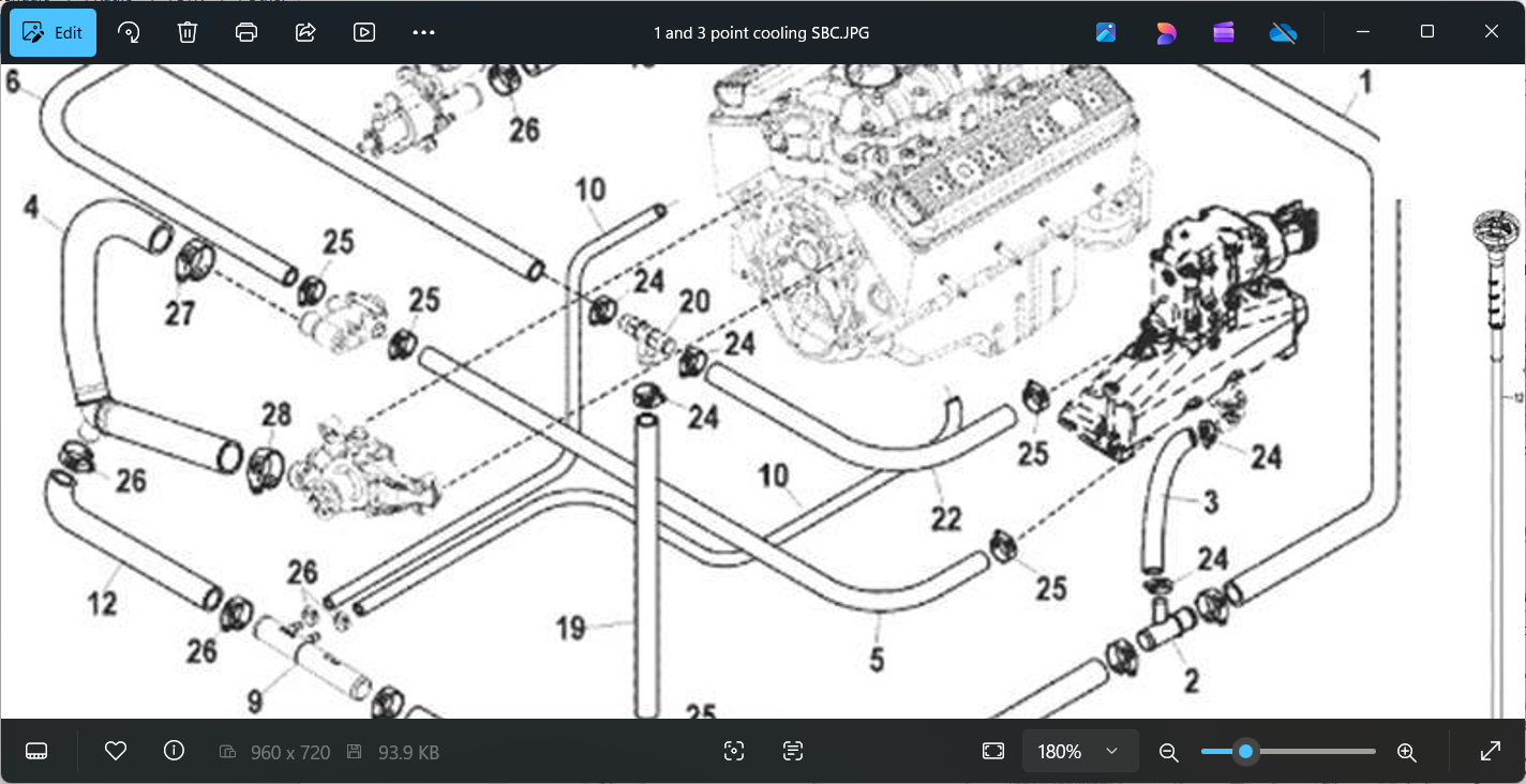

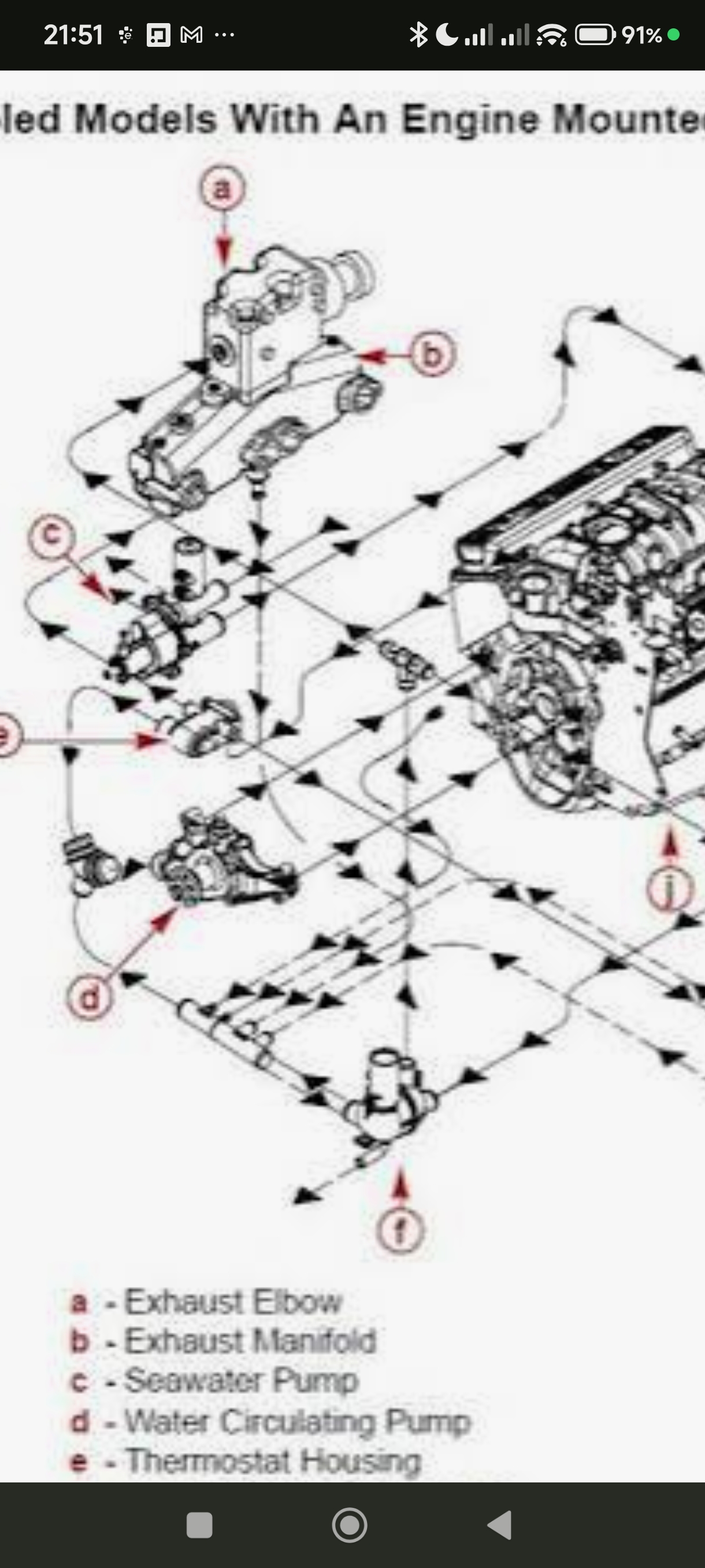

I was looking at this diagram and it seemed to me the thermostat closed allowed water to recirculate until engine reached proper temp then opened and allowed flow to the lower hose of the manifold.

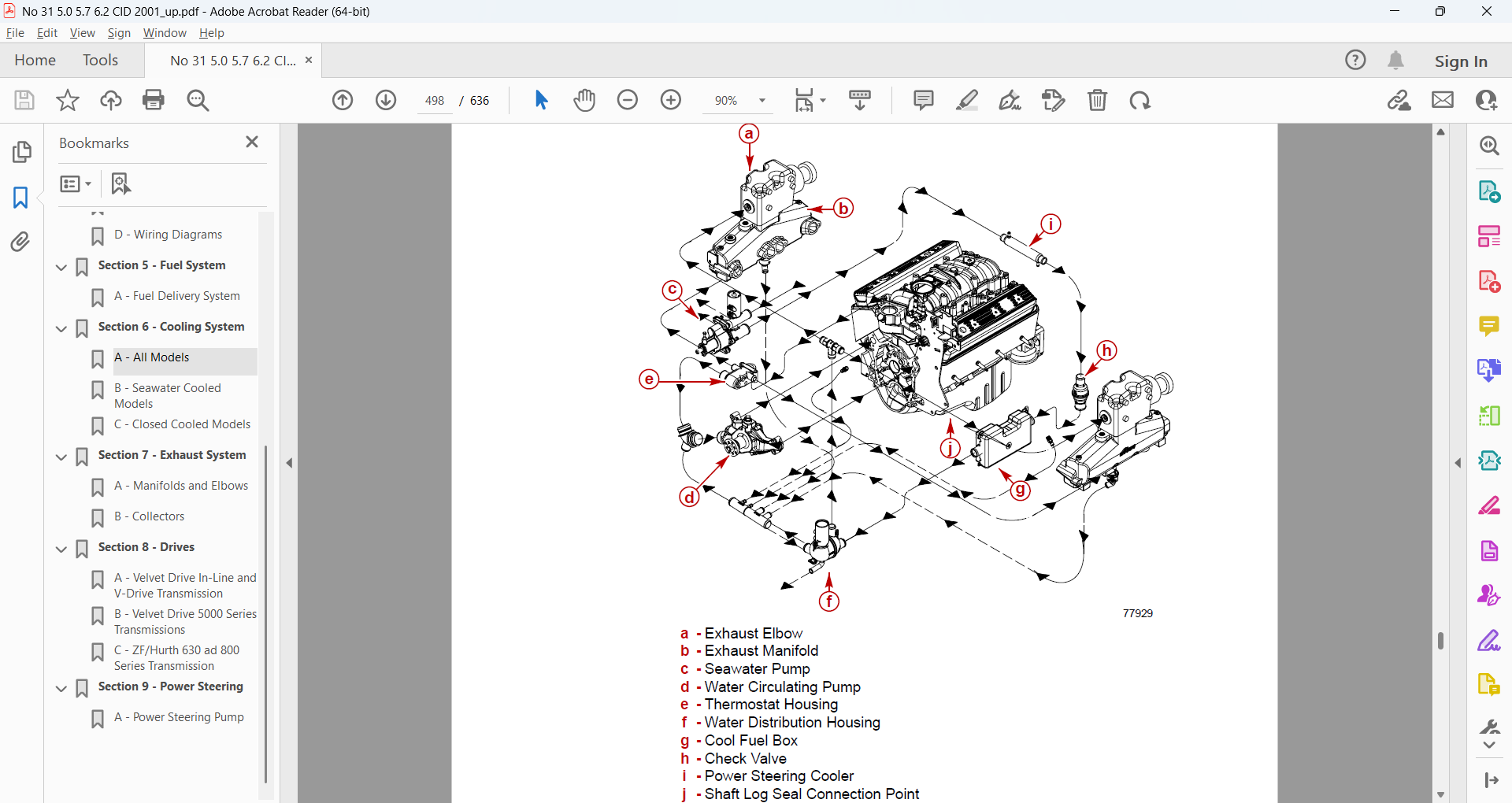

Might look that way but no, the circulating water pump keeps water circulating around the block so there are no hot spots. Temp comes up and thermostat opens allowing hot to exit and cool to come in. There is always more being pumped than the motor will use

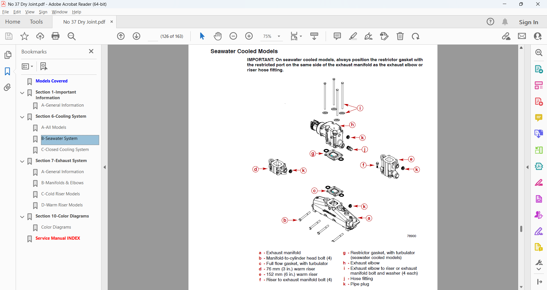

In your pics you have what is called warm risers

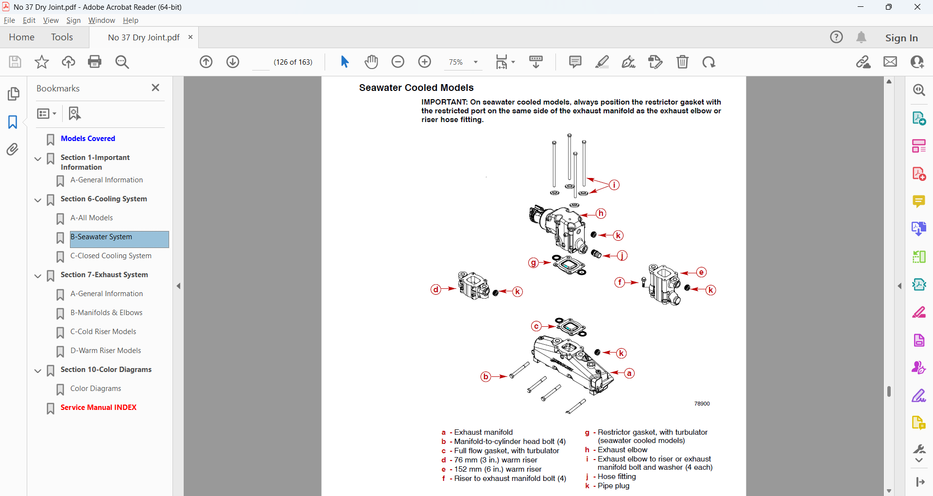

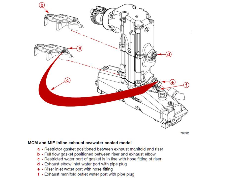

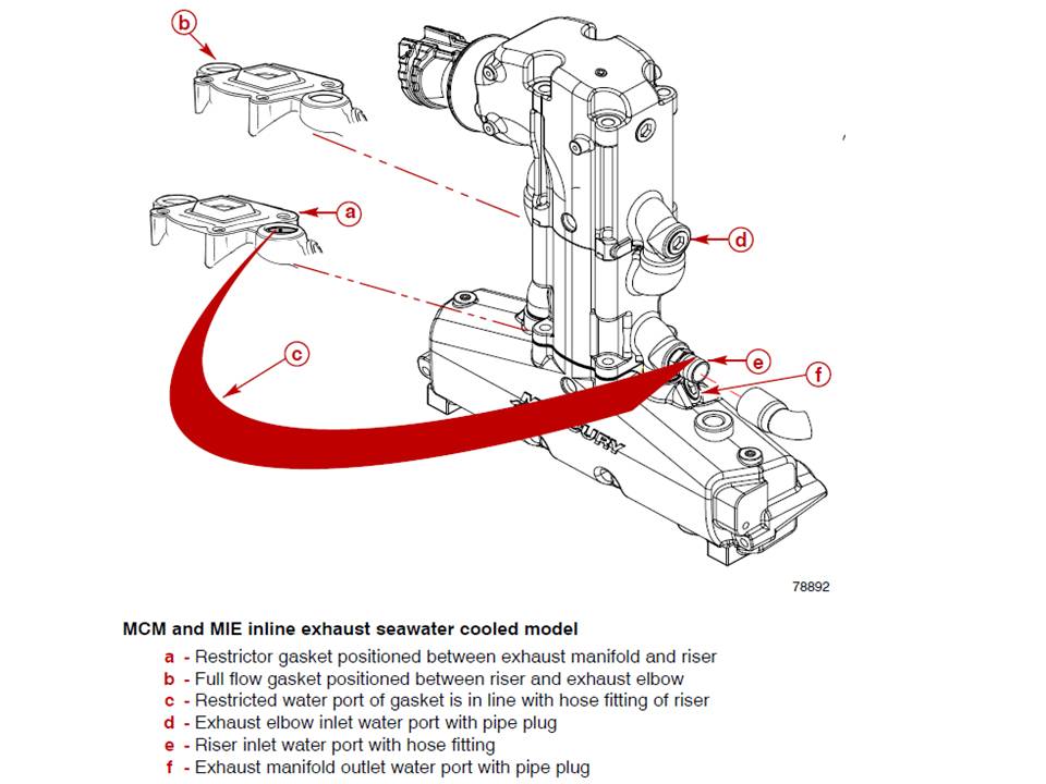

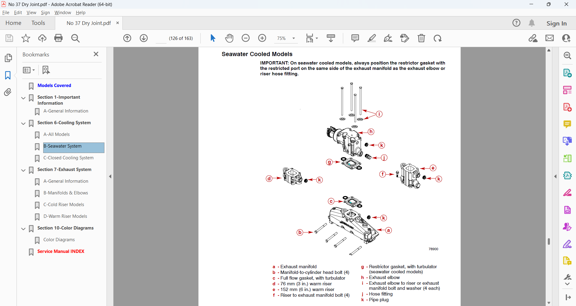

I this pic gasket C is full flow, so both round ports are full open holes
Gasket G is a restrictor so one side has a closed hole and is on the side of the exit exhaust. The other side has on small hole and is on the side where the hose connects to the elbow
This is the motor and agree with your color coding
The Blue lines gets full time cool water direct from the raw water pump.

The boat has warm risers/manifolds so the restrictor gasket will reduce the amount of water going thru them to reduce condensation. t idle the risers in most cases on one side will get hot enough to keep you from leaving your hand on it, but should not be an instant burn

"Might look that way but no, the circulating water pump keeps water circulating around the block so there are no hot spots. Temp comes up and thermostat opens allowing hot to exit and cool to come in."
That's what I meant. It looks like once the thermostat opens it allows flow into the top of the thermostat housing body and out to the bottom hose in the manifold, thus allowing more cold water into the block circuit. Using those hoses, the red ones I highlighted as a dump for hot water allowing the jabsco style pump to push more cold into the the block rather than just pushing it through the top entry in the elbow. I'm 40 years working on diesel workboats. Been doing this Mercruiser for a friend as a favour. I'll be out there tomorrow and getting some more accurate temps, more accurate than "it was too hot to keep my hand on it".

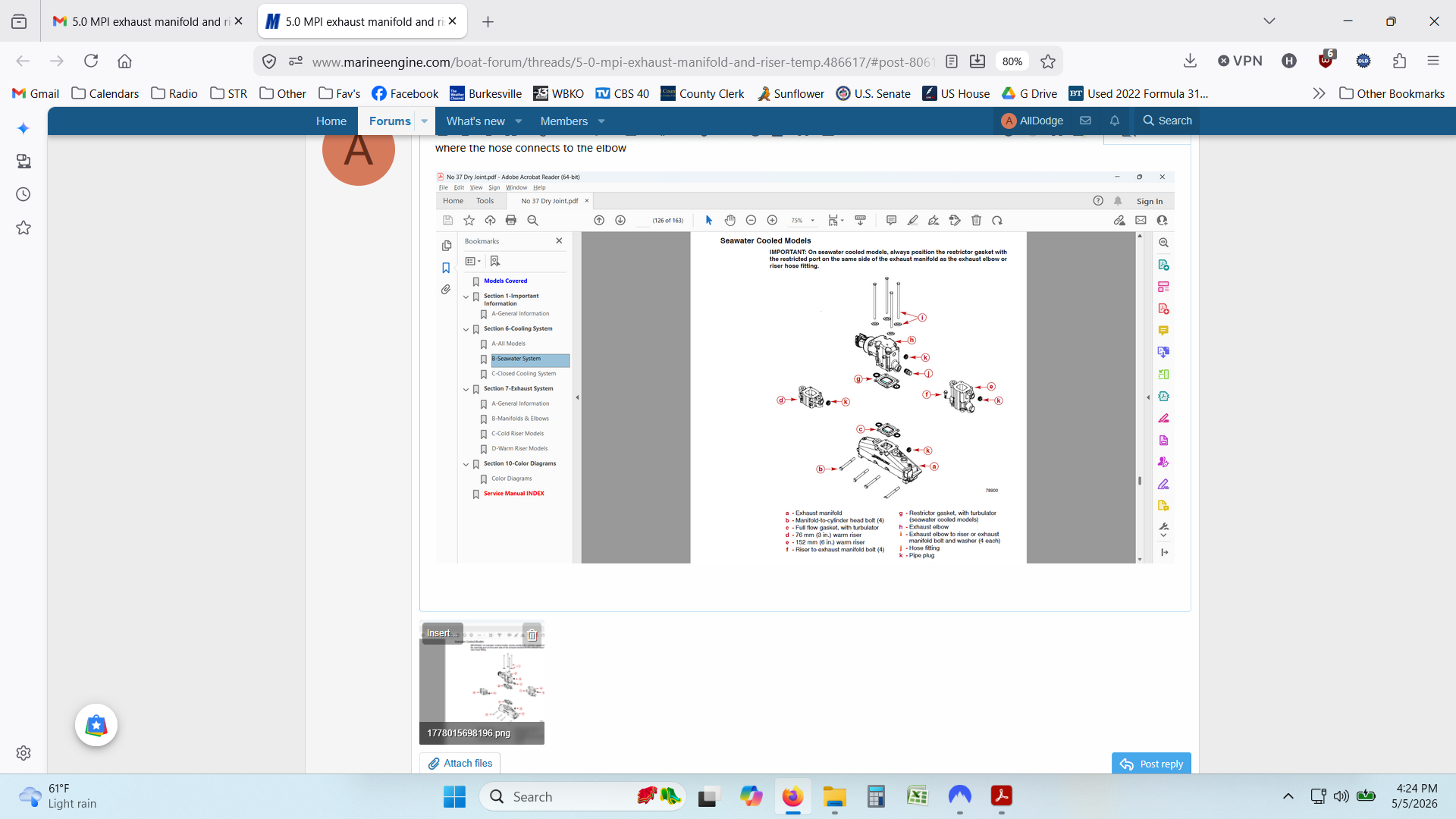

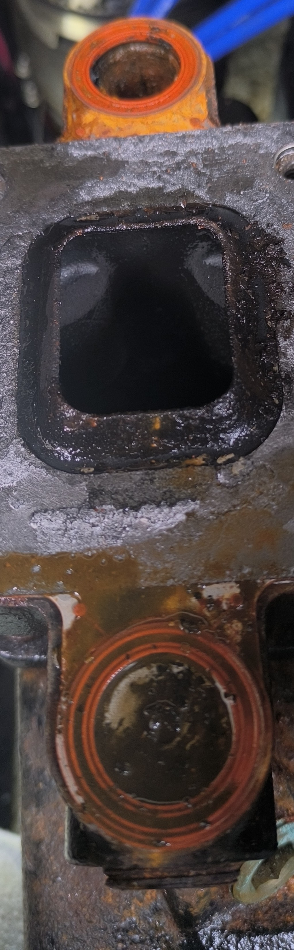

You said the G gasket has a closed hole and a small hole. This is a picture of the one I took off. Open on the exhaust side and small hole on the water inlet/front side.
The motor shows the Mans has Risers and Elbows
Gasket turbulators on Gasket face up
Gasket between Mans and Risers should be full flow, if pic above is the Man than it should be full flow. If pic is the Riser than gasket is correct
Yeah, it's the top of the riser. The manifold below it had 2 full flow gaskets and that's what went back with the new ones.

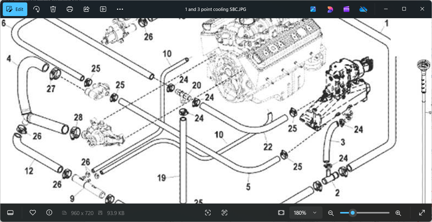

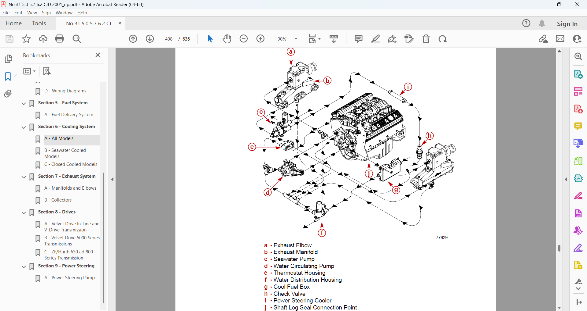

Item 20 in pic below is a reduced Tee fitting and should be slightly restricting the water flow to the elbows so the Mans get some.
The check ball above Item 24 should not pose an issue when running, and don't see both causing an issue at same time, if both Mans are about same temp
The one side restriction on the Elbow should not reduce the water thru the Mans a lot

The water from the water pump impeller pushes it to the single point drain and than divides up between the circulating water pump and the Tee (item 20). When the thermostat is closed the water goes in and out through the top of the thermostat housing and into the Mans. The Mans Riser gaskets are full open so water flows thru easy but gets slowed due to Elbow gasket with one side being restricted

The hoses are different on the one in working in. Hose 3 in your diagram goes to the drain manifold 9 on this engine. Also, at some time in the past the block drain hose has been removed from the block and drain plugs installed and the inlets on the 9 manifold blocked. I've only seen diagrams where the hose 3 is a drain direction. Does that also feed the manifold too? I'm guessing not as not as some engines just have a plug at the bottom of the tee on the manifold and not the extra no.3 hose
Yours is like this but with some drains blocked off
