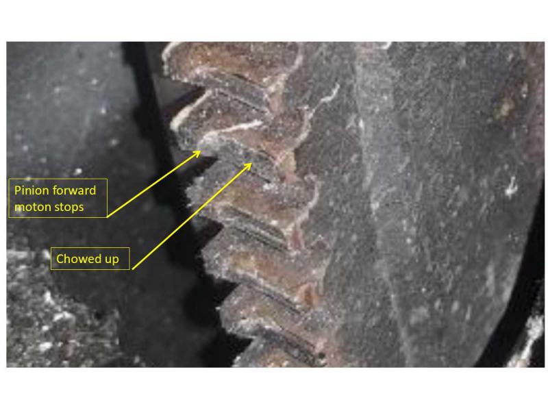

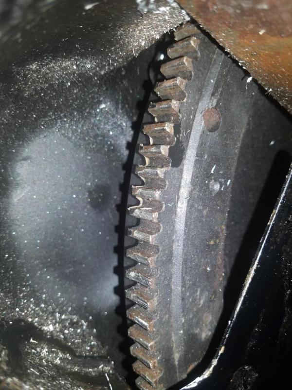

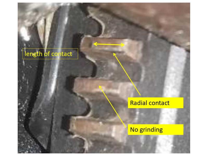

Have not fixed the timing problem and now have a new problem. When I turn the key, pinion engages and crank turns some from 1/8 turn to full turn and then crankshaft stops and grinding noise starts. Thought starter is bad and this time bought a merc $250 starter. Same thing. here is what I have done so far:
1, cleaned battery terminals
2. disconnected coil cable, so no firing
3. Used jumper cable thinking cables are bad
4. looked at flywheel ring gear , a small portion, when changed starter and looks good.
