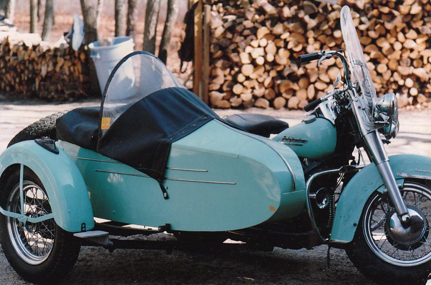

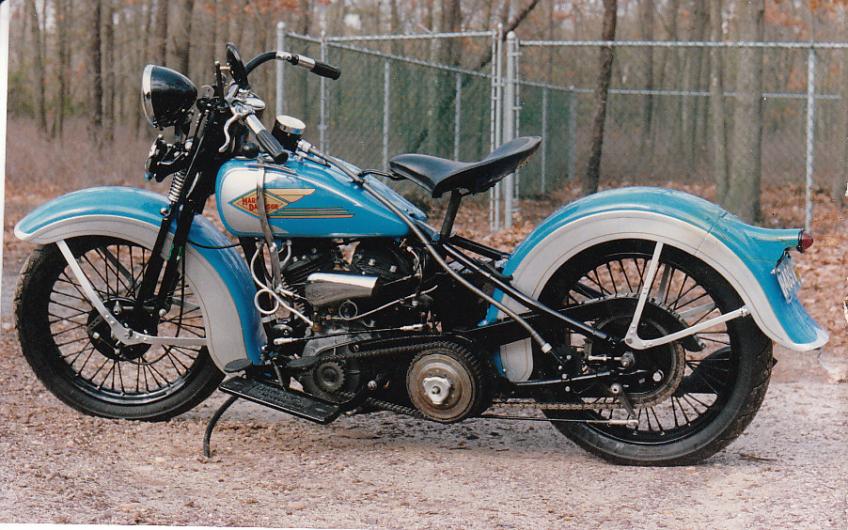

By the way: Knuckle47 comes from the great LAST year of the Harley Davidson 1947 knucklehead. It was my personal bike while I was actively restoring motorcycles. Started 1st kick every time. Looked like a rat but what a all original great ride...When AOL FIRST STARTED...they asked for a "screen name". Everyones was so odd, I chose "knuckle47"...THAT was probably 20 years ago...it stuck ever since.
So Mark...you are half shark and Dave must scuba dive ? :)
I know its off topic but in case you're interested in old bikes
