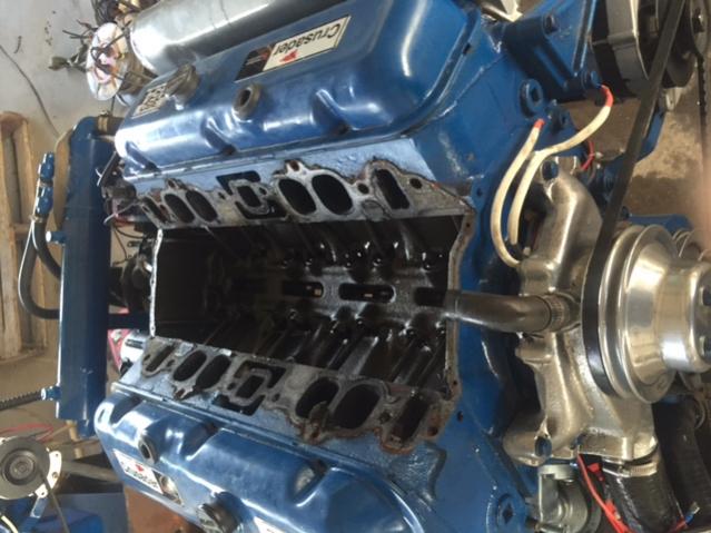

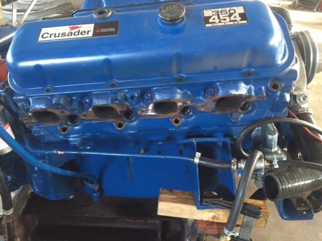

Hi everyone,
I am writing from The Netherlands where knowledge about crusaders is scarce Im afraid.
I have two Crusader 454's RH and LH
they have Quadrajet carbs and electronic ignitions.
One is running beautifully, the RH is running on 5 cilinders.
Before I took them out of the boat to paint them they were both running great.
All sparks (new) give a spark. I have the RH timing set up.
I've changed out the carburators and also the entire ignitions, but none of that helps.
The nr 3 and 5 dont do anything the sparks in there still look new.
Now I will do a compression test tomorrow, but I cant figure out why that would have changed as I didnt take the engines about.
I took off the exhaust manifolds to powdercoat them, but their back with new gaskets.
both my rotors are turning cw, whicj I know is what they are supposed to do. my starter engines each go in a different direction but I put them back in the right engine otherwise my rotors would turn CCW (right?)
I have the firing order in 12756348 (as is market on the plate above the drive).
Any suggestions?
