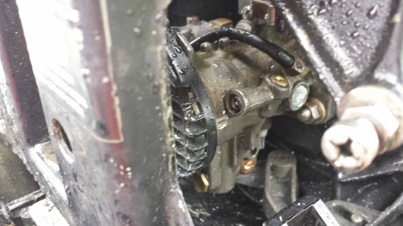

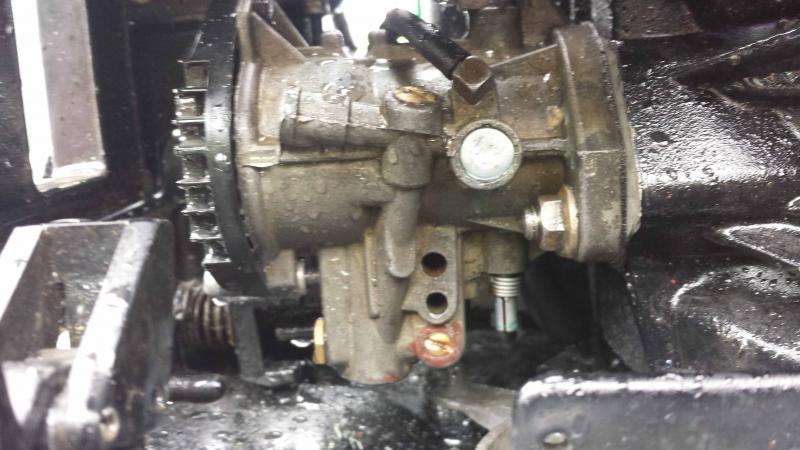

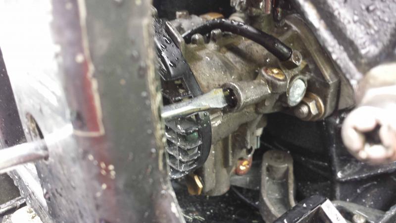

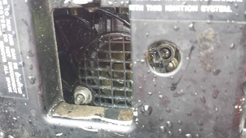

ok if in pic 1 you see if isn't the mixture screw you seen me turning in the 9min video or the other videos then what is it? as I was turning that screw 1 1/2 and 1 1/4 turns... and if that's not the mixture screw then are the 2 2 screws on the side there that are glued in

as I getting frustrated why its running rough if you say that's not the screw I'm adjusting in the video so I dunno what other screw is there.. as you see that screw driver in the engine as the engine is running and I just turn it slightly the other one I need to take the nut off is just to keep it reving the rpms higher in netural

Good compression numbers. The screw with the screw driver in it (top photo) is the one you're after. Start at 1 1/2 turns out and adjust with her in gear.
