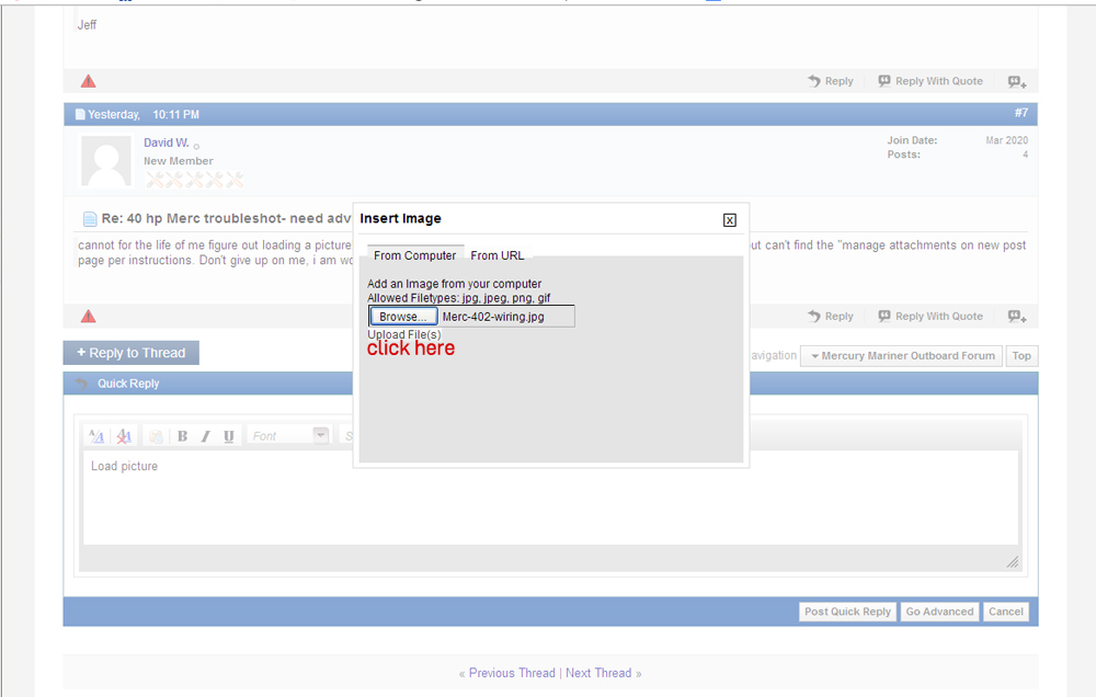

cannot for the life of me figure out loading a picture! Read and reread instructions, my computer said picture was uploading but can't find the "manage attachments on new post page per instructions. Don't give up on me, i am working on it.
Loading pictures: Untitled-1.jpgUntitled-2.jpgUntitled-3.jpg size (less than 200kb, say 185k)
