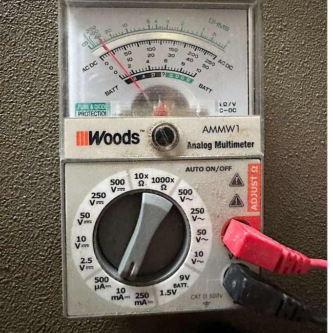

I disconnected the positive battery cable and touched the meter to the battery post and cable as you suggested.
This is the reading I got. I'm not sure what it means, but it seems like there's current, and you said there shouldn't be.

That shows 1 mA, which is very little. How long does it take to kill the battery?
Leave the meter connected and trim the motor up and down but reattach the battery cable and connect the meter so it measures Voltage- if you have a large current draw, the meter won't survive if it doesn't have a fuse- it's maximum current is only 1/4 of an Amp.
Measure Voltage while the motor is trimmed up and down- if the voltage drops significantly, you have short and that will require checking the harness where it bends or where it enters the motor shroud.
