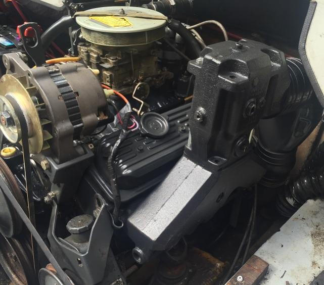

I have a 1998 Bayliner Capri with a carbureted 4.3L. I'm the second owner, I've owned & used it for about 12 years. I bought from my Aunt - she & my uncle were the original owners, so I know it's history from new. It has always been well-maintained & is overall in great condition. However, it has always had one nagging issue - once its warmed up it has a tendency to run-on or diesel when you shut it off. According to my Aunt it's done it since new. A couple shops have looked at it but never been able to get it sorted out. It's always been more of an annoyance than a serious problem, so I've lived with it.
Other than that it has always been very dependable, never a single breakdown. You can use it hard all day & the engine temp never gets over 170.
This week I shut it off in the water & it did it's usual run-on routine; when I tried to restart the engine would not turn over, like it was locked solid. Had to get towed to shore...I assumed a starter issue so pulled that this morning. But the starter is fine, bench tests OK & the gear teeth look new. So I tried to turn the motor over using a breaker bar with a socket on the crank snout & it would barely budge. Pulled the spark plugs & tried to spin it again. I got water out of 4 cylinders & now it spins freely. So it was hydraulic locked.
My questions are:
1. What the heck happened? My theory is that when it did it's usual run-on routine that somehow the motor went reverse rotation & sucked in water? Note it was definitely water, not fuel.
2. What do I do now? My plan is to shoot a little wd-40 in each cylinder & turn it over by hand a few times; then I'll leave it overnight & reassemble in the morning. Try start it & hope for the best. Anything else I can do?
3. Any thoughts on how to cure the run-on?
Admittedly I'm not a boat mechanic, but I'm a muscle car guy. I've built many car engines & have a pretty good grip on how engines work. I also know that hydraulic locking an engine can be really bad & can bend things like pushrods, connecting rods, etc...Now that I have the water out of it it spins nice & free so I'm hoping nothing catastrophic.
