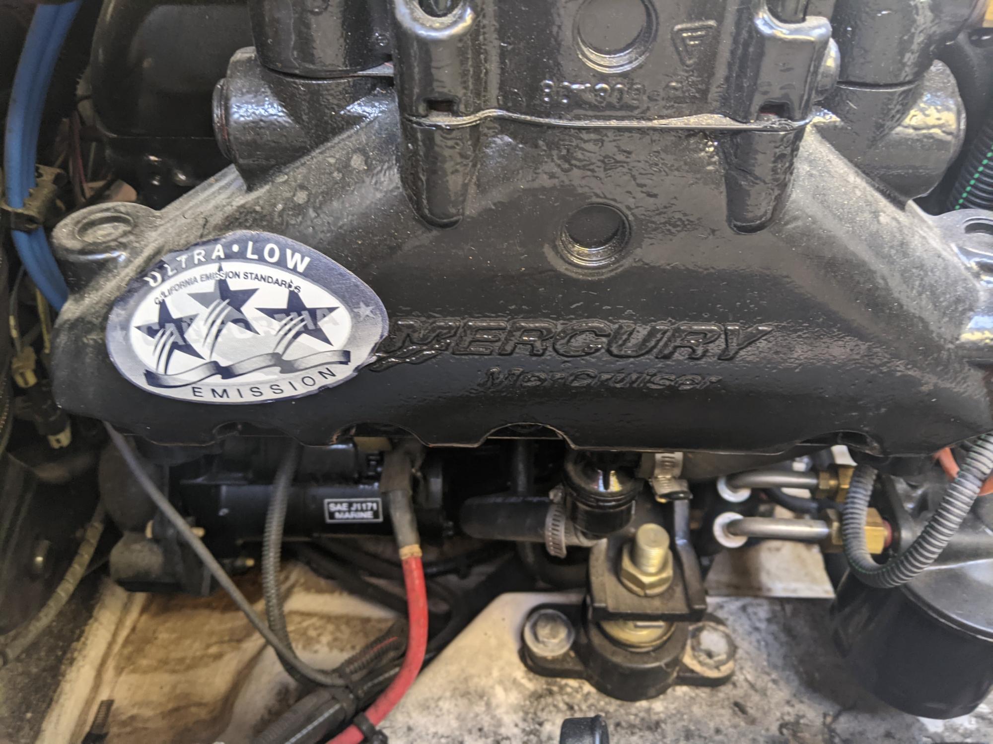

Can someone post some pictures/videos showing the method they are describing in the posts? I have attached pictures of my engine for reference if that helps?

thanks for the reply, so you have a multi point drain system? I only have two blue plugs, one on the thermostat and the other at the bottom of the drain housing unit where the rubber hose is that drains the single point.
It just seems odd all the videos never mention anything about checking the outlet hose connections for blockage. I never run in sandy or "dirty" water so I doubt there is any blockage but I get there could be rust etc. so I want to be sure. I am also a visual person so having a video showing the steps would be awesome!

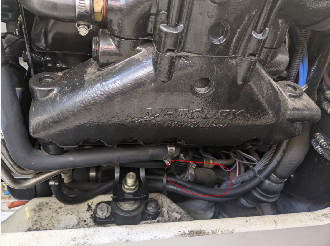

So for #15 & 16 drain the exhaust manifolds I believe I located them from the image below circled in red, this should be 16? If thats correct then I know 15 as well. I was able to find both 17 and the quick disconnect. If all this is true, I will try and get it done tomorrow!
That looks correct. Yes i have a 5 point drain. Would be interested to see if you have any debris in there.
