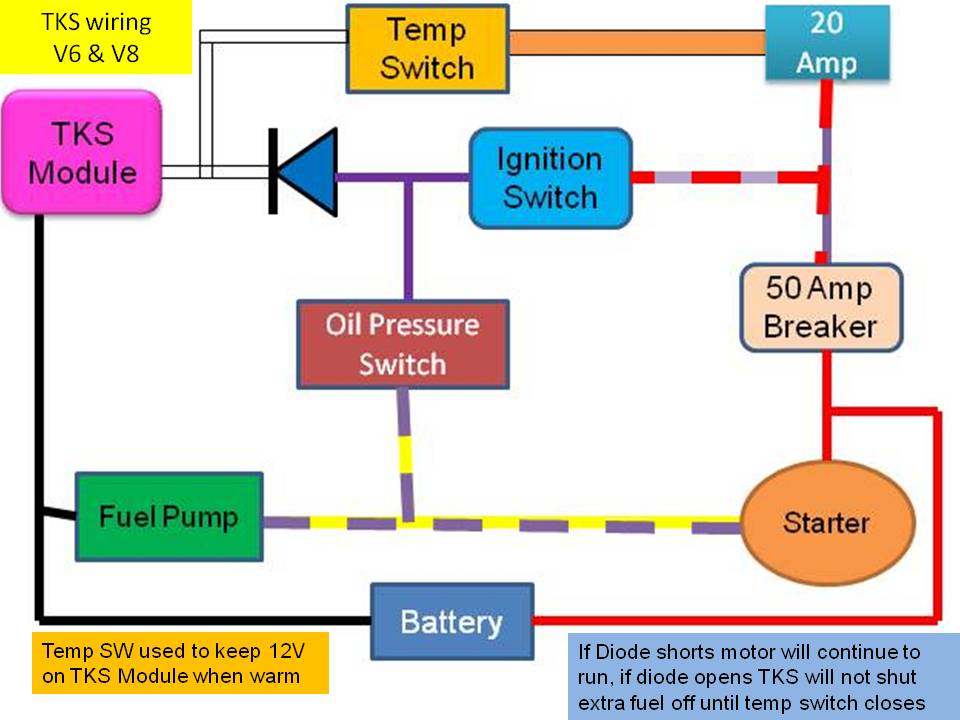

May also have an internal issue with the oil pressure switch that is shutting down the fuel pump 12-volt power before the engine dies out.
Item number 10, https://www.marineengine.com/parts/mercury_marine_parts/sn/1A080381/4211025US/13798_40
