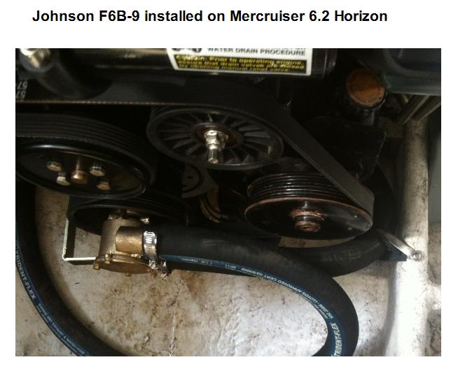

There is a rubber bushing isolated torque arm that is used to stabilized the pump body from any rotating force.
While I am not recommending this, I have been running both of my F5B-9 pumps without the torque arms since 04.
The pump's bearing and/or impeller would need to completely lock up in order for the body to spin with any significate force.
Does anyone have photos of how the Johnson F5B-9 or F6B-9 crankshaft pump would mount and plumb to a 2007 350 mag?
