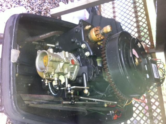

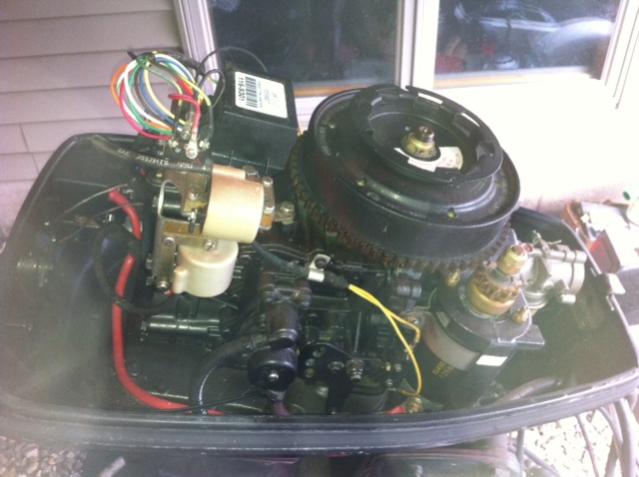

The charcoal grey is a mid 80's model.You need to post a few pics of the motor.Showing the coils,flywheel,fuel pump.Etc.

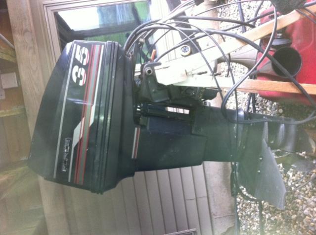

I'll work on posting pictures. Don't think I can post from the iPhone. Just noticed the word force is not a sticker. It's like a raised chrome car emblem glued to the cowling. Don't know if that is unusual But all the images I see are stickers.
Dang. I was hoping that could help determining the year. I remember my brother telling me it was an 88 but he doesn't remember for sure. There are a number of things that point to 88 such as the carb stamp and 88 casted into the engine block and the engine mount/housing. They are kind of starbursts with 88 in the center. Problem with using that logic is those parts could have easily been used with later models as well. I just think it may eliminate the thought of it being any older than that.

Go to boats.net Find this:
35 H.P. (1988) Mercury Force Outboard 357D8B IGNITION COMPONENTS Diagram and Parts This will be what you need.J
