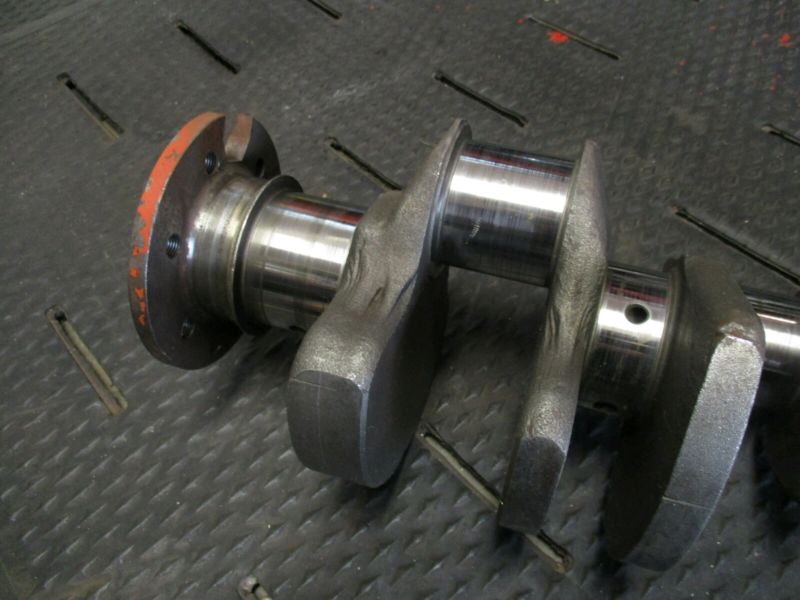

I removed the bearing caps and there wasn't knurling at all. Iread that on some cranks there was none?
This is a picture of a reverse rotating 340 crank doesn't appear
to have knurling for the rear seal.

The knurl acts as a slinger that tends to force oil back in to the crankcase. It will be usually be paired with a rope seal. The knurl is pretty much polished smooth for the two piece synthetic rubber seal as it can cause premature wear if not.

I can picture what your describbing. But i dont see it on my crank nor in the picture I posted above. Can you point it out in the picture?
The knurl will be fine slashes //////////////////////// or \\\\\\\\\\\\\\\\\\\\\\\\\\\\\\\ all in the same direction, all the way around the seal area of the crank. The slash direction will dictate crank rotation for oil control. Spin the crank the wrong way it will tend to drive oil out the rear seal.
