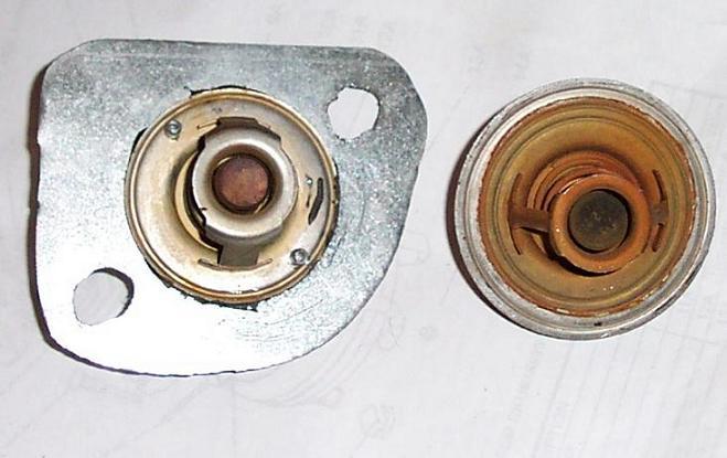

Due to rusting, the water is bypassing around the t-stat, which keeps the motor cold (and empties yur wallet quicker at gas ups!) The solution is make a metal plate (stainless) that resembles the gasket and epoxy/ rivet the t-stat to this plate. Use a gasket above and below, and that motor will warm right up!
Jeff
PS: Using this technique, one can also use the smaller daimeter (and cheaper!) t-stats.

Rust where the t-stat fits into the manifold. Mine are so bad the t-stat is gotta be rattling loose when assembled.
Jeff
sure are alot of holes in the bottom side of your t-stat JJ, dosent look like jeffs original on the right of his SS plate contraption!!
looks like a weird t-stat is my suggestion,after you clean up all that rust in the housing put the right 143 in make your own gasket to fit your intake and cut it just right so it ovelaps the first edge of the t-stat, you may want to do a double gasket samich if the mating surfaces have had enough or mill it
Jeff, is yours also a top hat style or the newer flatter style t-stat? When I pulled the t-stat I did notice that the design was very slotted. It didn't make sense to me why it would be so slotted if it was designed to hold water back....At first I thought maybe it was an automotive t-stat, but it has "145" stamped on it. I don't think auto t-stats were made to open at that low of a temperature.
The mating surfaces on the manifold and t-stat housing look great. The motor has barely 50 hours on it. I'm confident that water is getting by the t-stat. My only unknown was is it the gap at the top between the housing and t-stat or is it the slotted design, as you pointed out.

The pictures look like the seal has gone inside the housing..the thermostat should be a tight friction fit, if not its going to leak & let the water run right out
..."Jeff, do you have the top hat style t-stats or not??? "
Didn't answer you 'cause I'm not sure what that means.
Jeff
On your housing, maybe you could have some material milled off the face to tighten the fit up. Make sure there is .003" for the t-stat flange to "float" in so you don't crack the housing when tightening the bolts.
The entire t-stat fits up inside the housing with this style. There is no flange between the housing and manifold. Besides, the gasket creates all the clearance you need. No need to go mill a .003 clearance into a piece of cast. The casting tolerances are probably 3 times greater than that.
