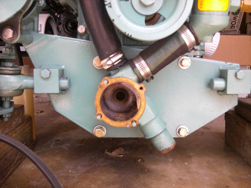

Can someone please help me to identify this pump? I want to rebuild it but need a model #. It's dual impeller on a late 312 Interceptor.
Thanks!

the pump pictured is eather a 9870-G earlier 14 blade vain pump or a 10270-G with 2 impellers.
14 vain assembly # 09745 SHE
2 impeller kit #09959K not sure if this is for 1 or 2 impellers.
Hope this helps !
