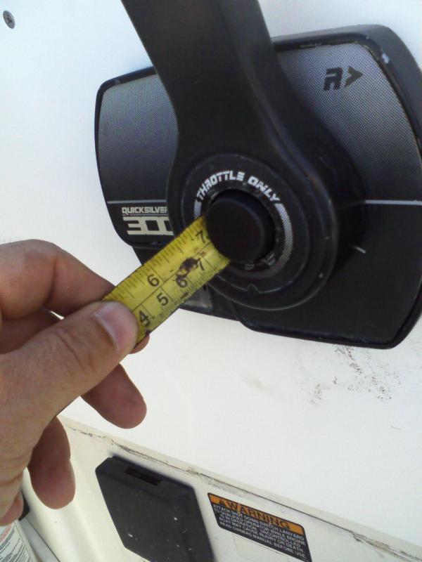

Here is the BEST and ONLY non-destructive manner to pop-out the Throttle only button for a Mercury Classic 3000 Quicksilver Throttle.
Make sure your throttle is at 12 o'clock in the neutral position. Then use an old or new but WIDE METAL MEASURING TAPE that has the "end-catch" removed, this will be the perfect device that is rigid enough yet still thin enough to slid in between the button and the housing. Once you have slid it in 1"-2" rotate it in either direction around the axis of the button, while simultaneously pulling outwardly and simultaneously applying pressure toward the button's center,.. and the button will pop out. MAKE SURE YOU DO NOT USE A SMALL SCREW DRIVER TO PRY OUT THE BUTTON AS PER THE MANUAL SUGGESTS BECAUSE THAT WILL SCARE THE PLASTIC BUTTON'S EDGES, DEFORM THE PLASTIC EDGES OF THE BITTON AND RAISE PLASTIC BURS THAT WILL CAUSE THE BUTTON NOT TO SPRING OUT OF THE NEUTRAL POSITION IN THE FUTURE. Once removed,.. if the plastic throttle only button has the edge of the plastic button deformed or scared or has raised burs,.. be sure to purchase a new button for $3.00 or lightly sand smooth the circumference for that no plastic burs are raised and apply a little lithium grease and all should be well again.
ONE MORE BIT OF NEWS,.. MERCURY MARINE TECH SUPPORT WAS USELESS,.. AND THE MANUAL'S SUGGESTION OF USING A SCREW DRIVER TO PRY IT OUT IS BAD NEWS,.. BUT WORST OF ALL WAS A GUY NAMED "DAN" at Mercury tech support,.. who could only quickly dismiss me by telling me to take my boat to an authorized Mercury Marine service dealer.

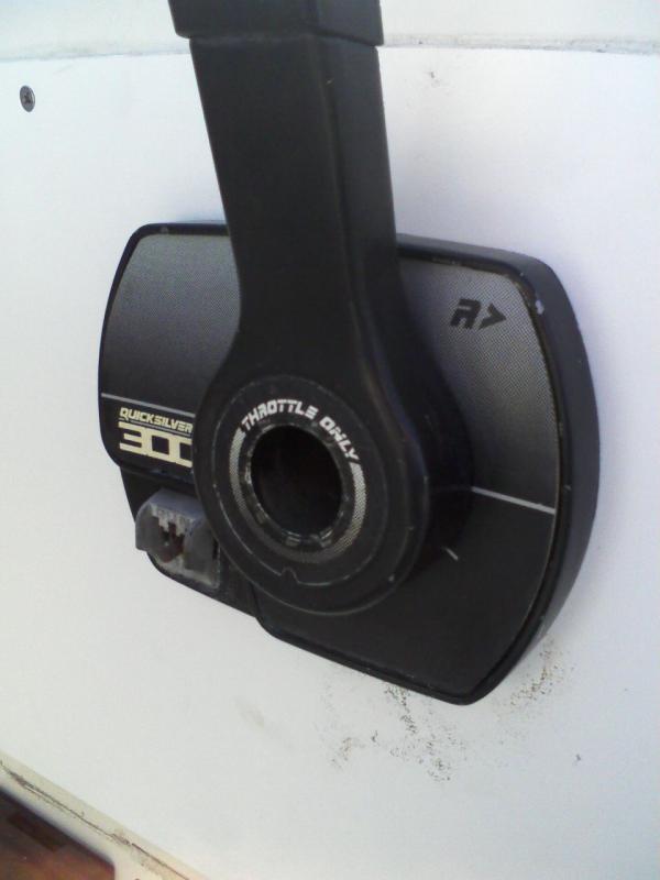

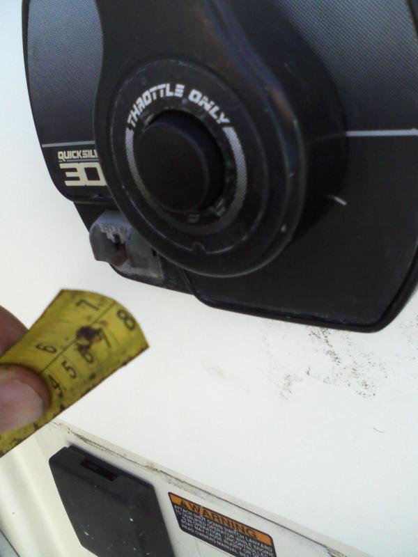

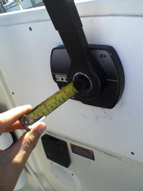

Throttle Only Button Removal done without destruction of the plastic button correctly as per the PHOTOS,.. remember do not use a screwdriver.

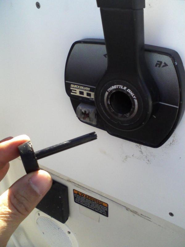

The correct way to remove the button is to push it in and go to W O T, then pull the button out anyway you can, by getting behind the edge of the button and carefully pry it out. Regardless if those directions work or not, (Your button?) or the button in one of the photos you posted above appears to be broken as evident in the three photos below. look at the end that goes into the controller. This button usually breaks when being pulled out incorrectly. You may need a new button, Mercruiser part number has superceded from 822212 to 822212T.
Broken,
New,
attachment.php
New ^^^.
