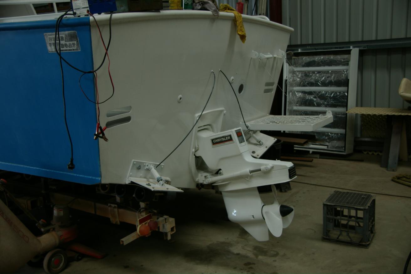

Hey Rick, here is a pic of the drive I have. I was told by some guy that the exhaust had to run though the drive for cooling purposes. I'm not sure if that true or not.
Thanks, Jimmy
Yes you have a Chrysler. We are all experiencing high increasing prices for all of our chrysler parts. Exhaust risers and elbows have increased by at least 25%. To name just two. Supply and Demand. I see you have a Merc prop on it. 16 splines on the prop shaft. Chryslers do not work on merc. The exhaust boot is important, just as the black flapper on the leg. Both stop water from entering when you stop or turn off the engine. Always have your engine at idle for about three minutes before turning the engine off. It is the same as stretching when you have finished an exercise routine. The exhaust water and fumes are best to exit through the leg. It has less disturbance. There have been post about showers on the legs. I do intend to make a proto type for my leg. You may be able to buy a mercruiser or another brand. Who knows what else you could find. I would be interested on any info on a store bought shower. The cooler the oil the better. The three boots are important. Annually completely remove your leg and servive the uv. Do not forget to grease the point on your bell housing. If you spend 4 hours a year doing the complete maint.Servicing the leg. Drain from the bottom and FILL from the botton. Have you removed the top cover to look at cones and gears? You have a dip stick on that top cover plate. Remove it when you drain and fill the leg. Leg MUST not be tilted when changing oil. Two containers to collect the oil, first to enable collection of the initial drain [ you can see what is it ], second the remainder. Do not over fill. What type of oil do you use? There is a small hole in the front of the buttom of the leg , make sure that is clear, to enable water to exit. Do you have a parts and service manual? I have assumed that you are like me. STILL LEARNING.

Jimmy,
I also noticed that there is a large piece of your skeg missing from the bottom of the leg. Check the attached pic.
You will have to get this repaired or replaced as it is there to protect the prop and give you directional stability.
You will also see in the attached pic the correct prop for this leg.
Mike

Mike, I noticed the skeg as well, but didn't realize it was that bad! Nice looking boat by the way. I figued that the guy was just blowing smoke, I just wanted someone else to agree with me before I started cutting holes in my transom!
