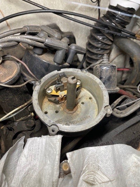

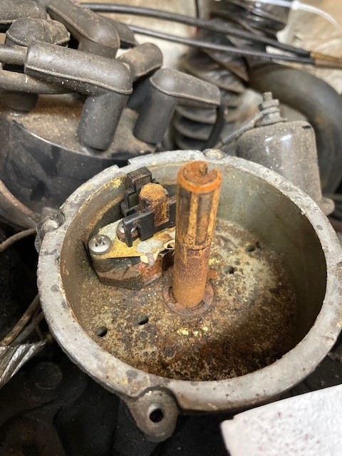

Here is what mine looked like when I bought it.
