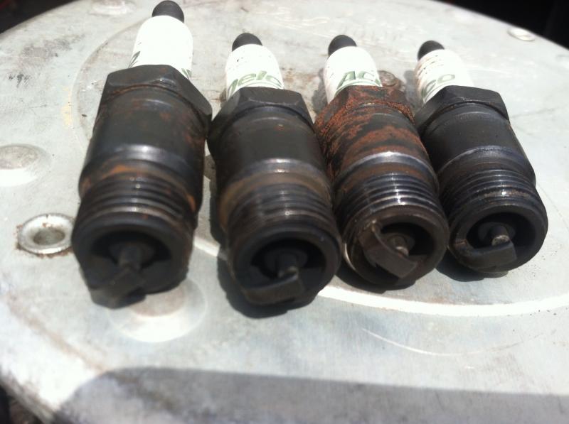

Relook at the speak plugs and carefully compare number 3 with the others...if possible post pics and label number 3 for comparison.

Will post a pic of the plugs in a minute ..

Not sure if the pic of the plugs got attached, Ill try again

Plugs are left to right 1,2,3,4
these are what was in it, The new plugs don't show anything yet, as I have only ran them once around the lake and maybe 15 minutes on the trailer...

Why is number three plug look rusted on the metal body? Do you have a small water leak?
If any water is reaching this plug while running it can and will short the plug to ground........very common problem with closed cooling systems when antifreeze makes its way to the plugs on the old 470's......
It just may be coincidence but need to ask.
