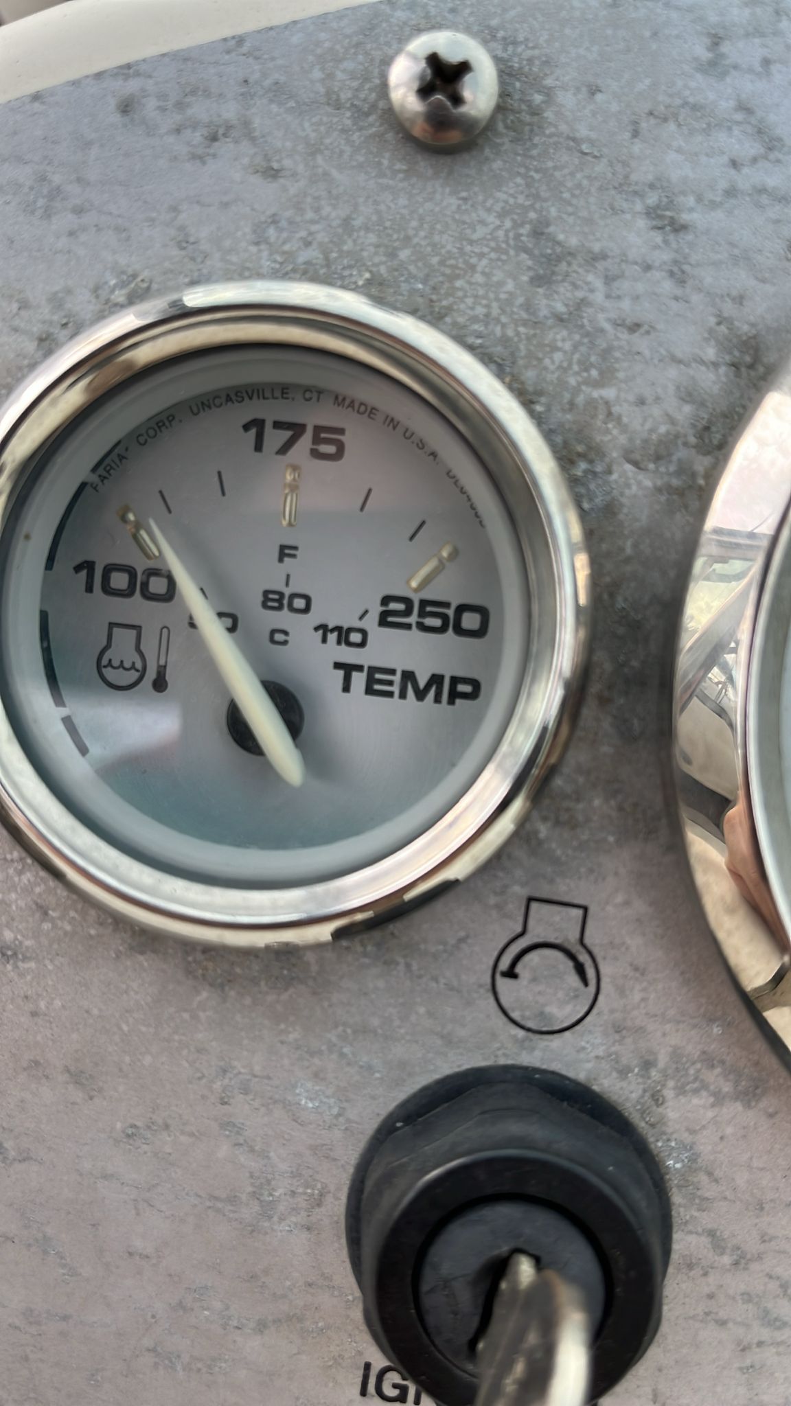

I have a 2011 model bayliner 175 gt with my 3rd tks engine and alpha one steen drive. I removed and renewed the engine and stern drive for overheating problem and rectification. The engine is working properly. I also installed a new manifold. I did not change the exhaust riser.
"Regarding my main issue, there is no problem up to 3000 RPM after the engine starts. During this time, I reach a speed of about 16-17 knots. However, when I exceed 3000 RPM, the engine temperature quickly rises from 80 degrees to directly 125-130 degrees, and it does so very rapidly, taking just a few seconds to go from 80 to 125. If I ease off the throttle and slow down, dropping below 3000 RPM, the temperature quickly drops back down to 80-70 degrees within a few seconds. This rapid fluctuation in temperature, either rising or falling, is quite unusual.
To address this, I've checked the impeller, looked at the hoses coming from below, and noticed a significant amount of water flow. I removed the hose going into the thermostat housing while the engine was running, and water was coming out from there too. I also tried running without the thermostat, but the situation remained the same. I must be missing a simple step somewhere. If you have any insights on what this could be, I would appreciate it. I'm a mechanic and specialize in motorcycles. This developed as part of my own project, but I feel like I'm overlooking something. Thank you for your assistance."

The temperature sensor has been replaced. The alarm sensor is also new. An external laser thermometer gives similar readings. The incoming water suddenly heats up. When the gear is in neutral, you can rev the engine as much as you want without any issues. However, while in gear and moving, overheating occurs after 3000 RPM. It feels like hot gas is mixing into the water. When I disconnect the water hose going to the thermostat housing at idle, there is a significant flow, and the water is cold. The engine overheats only when it is under load.

Sure, I'll include the Fahrenheit degrees: Up to 3000 RPM, the temperature stays at 175°F, but as I continue to accelerate, it rapidly rises toward 250°F.
