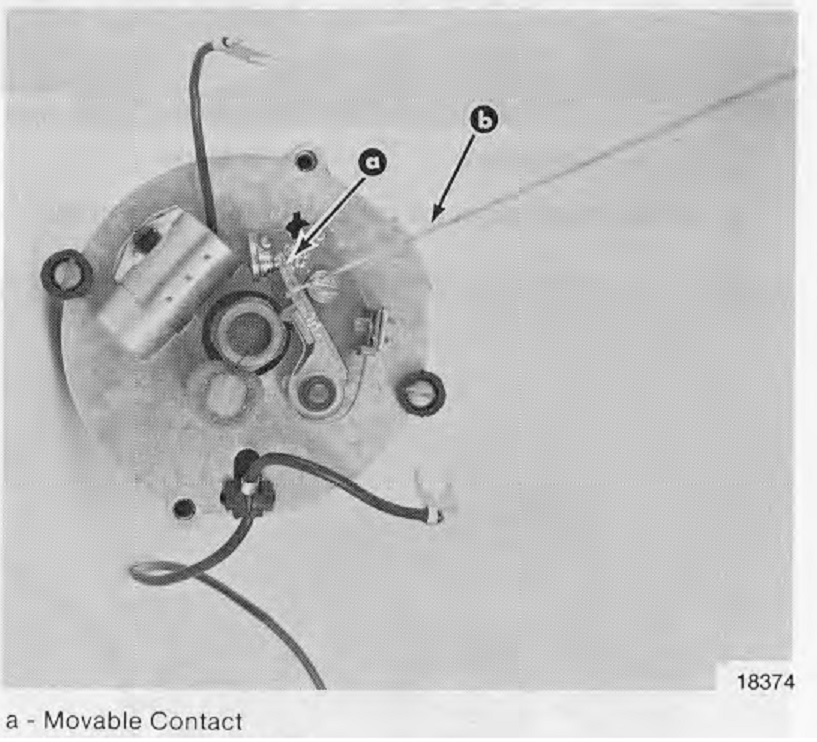

Carefully remove the distributor cap,
You will see.
Carefully separate a (points) and use some FINE sand paper. Carefully move sand paper back and fourth a few times. The point cantact surface is most likely oxidized and the sand paper will remove the oxidation.
Once completed, Blow area clean of any grit left over.
Now try to restart. If it does, Purchase a TUNE UP KIT, Points. Rotor and Condenser and find someone who KNOW HOW TO TUNE UP A POINT IGNITION.
This will have to be done EACH SEASON! So you may want to consider buying several tune up kits all at once for a supply for upcoming years.
