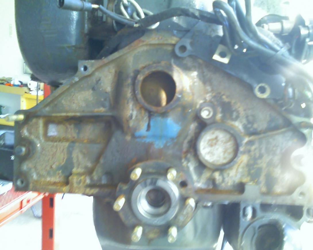

hello guys. I just put a new freeze out plug in the back side of 3.0 cobra OMC block. was wondering now I herd they were to use brass in them ,but however these were galvinized plugs. also i didnt know it but there were two freeze out plugs in the back side on block. Also I was wondering if I didnt upset the setting on the front motor mounts do I need to realing this thing? This is out of a 1988 bayliner capri
i didn't want to bring this up but a casting plug popping is a sign of something bad.
Bad, bad, bad. You got the motor pulled ? Start it on the crate, put water to the t-stat, and see where if any cracks are ? If all is good paint the whole motor and pan with 3-4 coats of paint.
