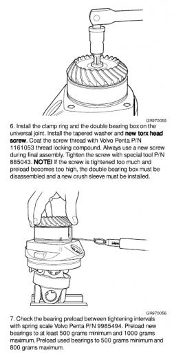

3. Could someone explain the bearing preload measuring procedure to me (attached below)? Do you simply lock the u-joint in a vise, hold the drive gear in your hand to resist movement, tie a string around the bearing box connected to a spring scale and pull? 1.10 - 1.76 lbs seems so low I would think this is difficult to accomplish with great precision.....
