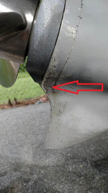

Can someone please help identify the potential sources for this outdrive leak so I can begin researching what it is going to take to stop it? Tough to see because it is brand new oil but i have a slow leak from behind the inner prop. Thanks.

It looks like the bearing housing has been removed lately. There are two O-rings that should be replaced whenever you pull a gearbox apart you should always replace all O-rings. Pull the props and see if it is coming from the seal area or where the bearing housing meets the gearbox?

it hasn't been lately. last owner did when he overhauled the unit. i saw the o-rings on the diagram. i can remove the props and take a look. it leaks from gravity alone if that helps any.
I think, and I am no expert, that if the prop seal needs replacing, you really need to be mindful of the shims. I don't know if replacing the seal requires re-shimming, but I know there are some folks here that will be able to tell you
If it is just the O-rings I believe you can just pull the bearing housing and outer shaft out all together and just replace the o-rings. If your replacing the seals just be careful you dont lose or damage the shims when you pull the outer shaft out of the bearing housing. You only need to go through the shimming procedure when changing the gears.
I agree with Kim.
Furthermore, drain the gear oil (capture it..... it can be re-used if clean) and perform a pressure/vacuum test.
As for removing the prop shaft bearing carrier, you may need to build yourself a puller tool that Volvo Penta has not offered.

None-the-less, the prop shaft bearing carrier and the FWD prop shaft can be removed (for seal replacement) without even seeing a shim.
Dealers and Shops do not want you to know this! :mad:
The FWD prop shaft seals are within the bearing carrier.
The AFT prop shaft seals are within the FWD prop shaft.
Please note that the dip stick and drain plug O-rings must be replaced also!

If it was me I would replace the seals and o-rings all at the same time. They are back to back seals be careful not to get any perfect seal on the rubber parts of the seals that ride on the shafts. Did you determine where the leak was ? Is the line cutter in good shape?
Line cutter is in good shape. I have not had a chance to get the props off yet. will report back in.
