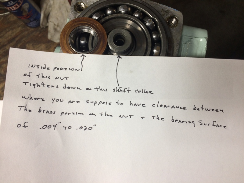

On another question or clarification for the axial shaft left handed nut. In order the get the proper clearance (0.004” to 0.020”) between the copper washer on the nut and the bearing surface, is it the inner portion of the nut that has different lengths that will be mated to the axial shaft (lip) collar that gives us the required clearance?

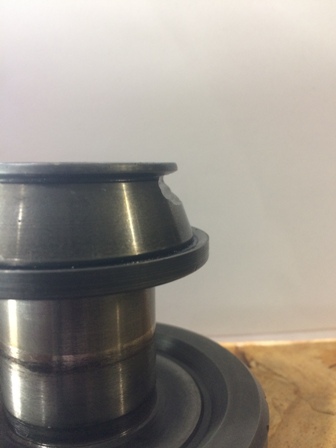

Here is a helpful thought when trying to remove the race from the input gear shaft. I did not think of this, it was on someone’s Youtube channel which I do not recall.
Using an angle grinder with a cut off wheel, I cut a recessed area large enough on both sides the race ( 180 degrees apart) for the jaws on my “little” 4 inch puller to get a good holding surface. I cut a circle from a piece of steel that covered the end of the input gear shaft so the puller had something to push against. Using a propane torch with a small tip I heated the race a bit and proceeded to pull it up. I tried to only heat the race for it to expand some without getting the input gear shaft warmer than needed. I took my time and it took about 3 heating attempts for it to come off. After the race is lifted some it is possible to reposition the puller so the jaws are under the race.
