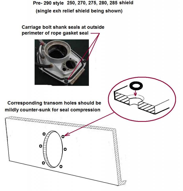

We can use a small amount of 3M 4200 or Boat Life "Life Caulk" in the grove and at the surface if need be.
You will want to replace the 6 carriage bolt "shank" seals, and again use 3M 4200 or Boat Life "Life Caulk".
Your transom shield mounting bolt holes will be (should be) lightly counter-sunk for seal compression. (I've seen some that were not!)
Easy to do if not!
