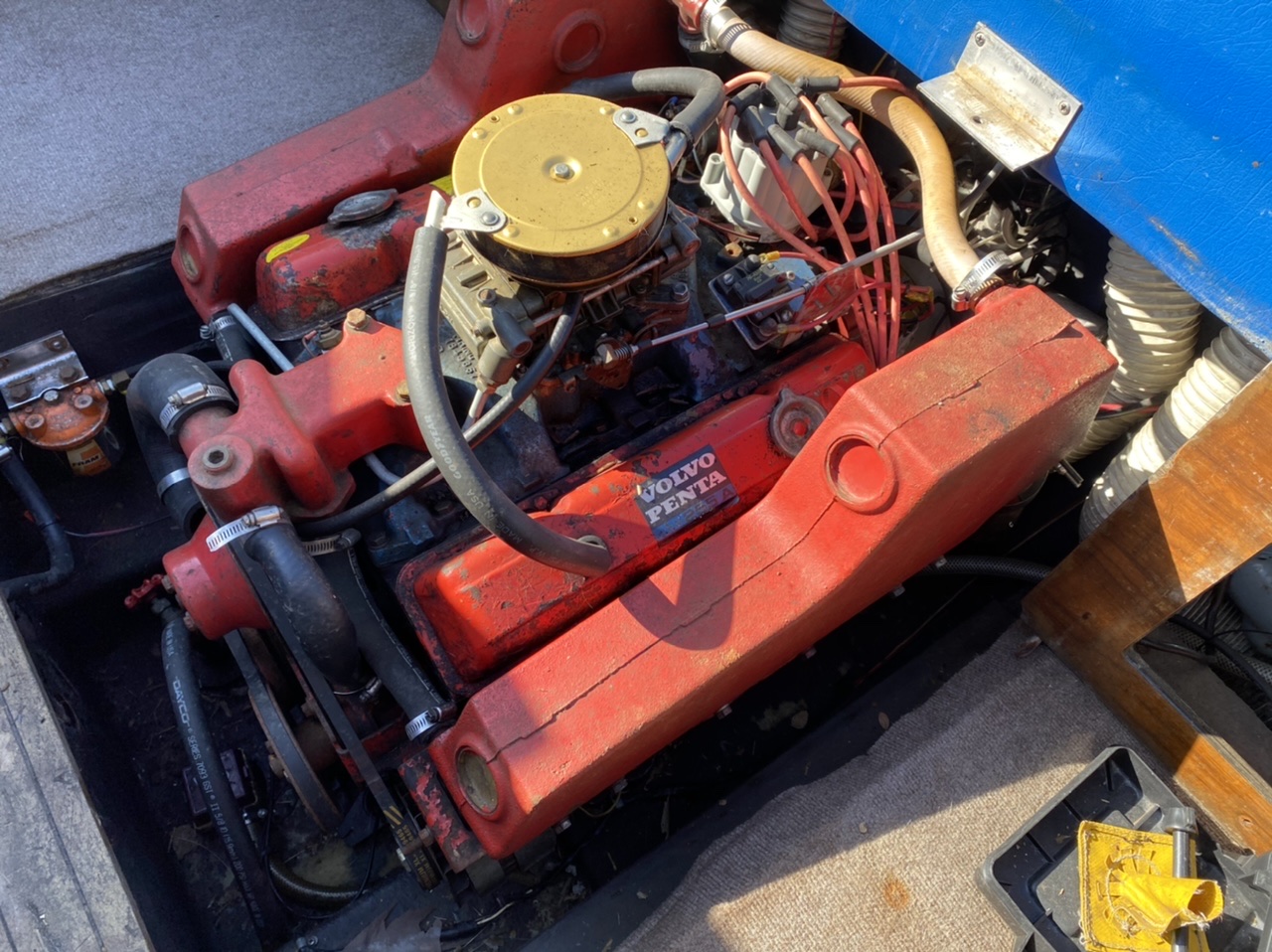

FCA9AE8C-2DDF-4BD9-8888-DCA7349AABFE.jpegMotor
valve covers say "volvo penta 255a"
The AQ 255 is a marinized SBC engine.
i havent much about this at all, block numbers say its a 68-70 Chevy 350, its has .60 over pistons (i did find on rebuild receipt for engine cicra 1999) and it has a holley marine 4bbl card and an adapter plate- carb #'s indicate it was for a 351W ford. The boat was all raw water cooling, i have a marine heat exchanger so i think during this process I'm going to hook that up and make it a 1/2 closed system. Seems like a fairly simple project and the benefits seem worth it to me.

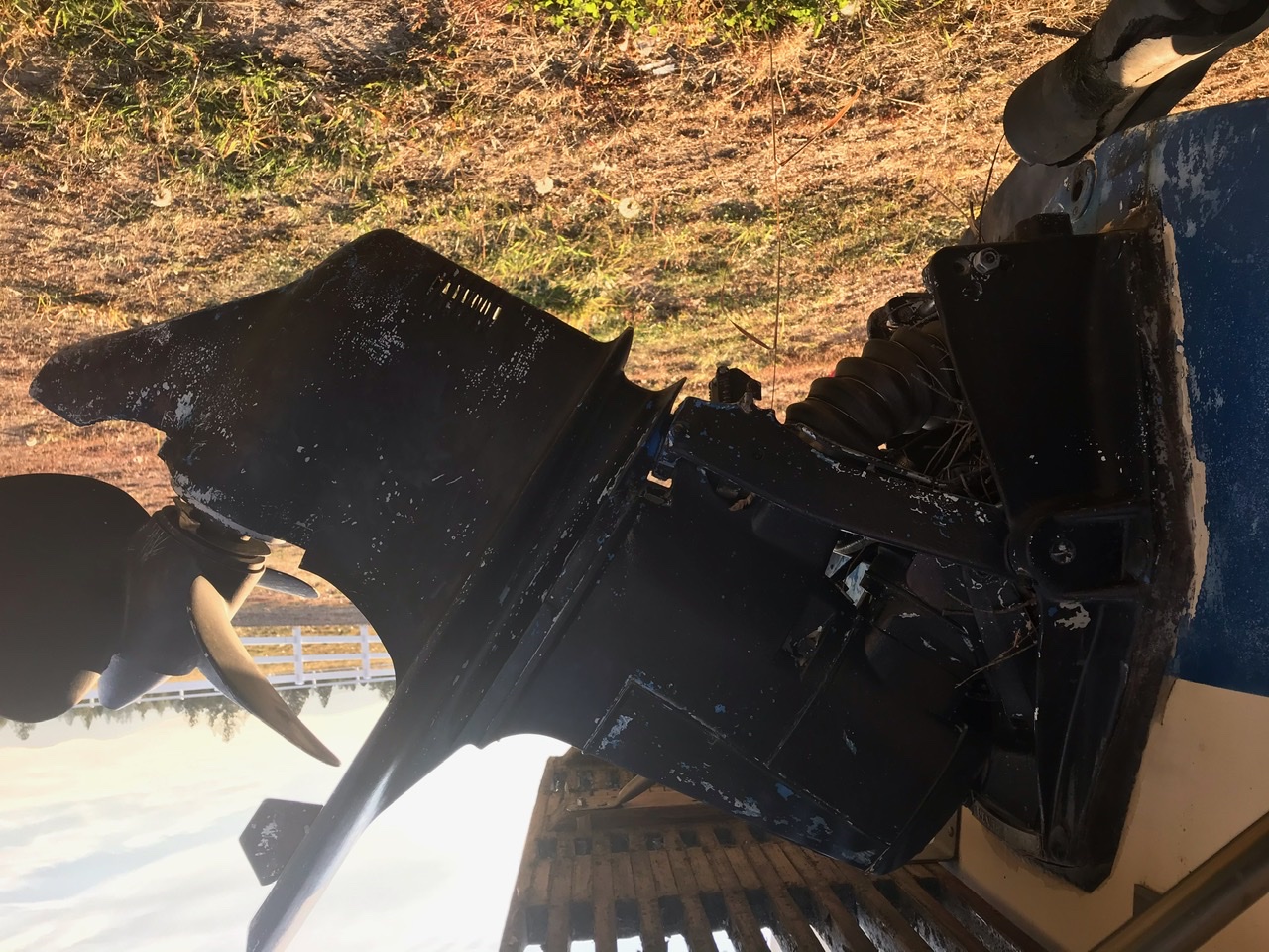

the sterndrive as a "280" id plate on the removable cover, the billows need replacing and some wasps had made a home in the outdrive intake and exhaust inlets. the inside of the outdrive only has a yellow sticker and no ID plate that i can find. the outdrive oil was clean and clear and i could tell the system was sealed.
In 1978 there's a good chance that it is a 280.
All of the rear shift mechanism covers (of this style) interchange, so I'd not go by that alone.

If you have this style exhaust manifold....................
.... you will have a double exhaust relief transom shield.
This transom shield is very difficult to find these days.
Im excited to get this boat back on the water (freshwater murky texas lake) that you all in advance for any help and advice, pictures coming shortly.
Pictures would be very helpful.
OK, now that I can see your photos, you have an AQ200D or an AQ225D exhaust system.
The transom shield is a single exhaust relief style, and is much easier to find.
Those exhaust manifolds have served their time.
I would replace them with 3" Barr.
I also notice that you are missing the prop shaft ring anode.
The ignition distributor may be an automotive unit. If so, that needs to replaced.
The fuel filter is old school. I would replace that as well.
You also have the old school belt driven Sherwood seawater pump.
These often cause an owner to defer impeller maintenance due to the time required and the difficulty to access the impeller.
If you replace the exhaust manifolds, you will be removing the Sherwood seawater pump mounting bracket.
This allows the use of the much better Johnson F5B-9 crankshaft pump.
The F5B-9 will outlast the Sherwood 10 to 1 or even more.
So these are not original manifolds for this engine?
what is the flaw of these manifolds? if I remove freeze plugs and clean and dont see major rusting inside are they still serviceable? im not familiar with 3" Barr exhaust but a quick google brought up kits for GM motors, but at aroudn $1000 id hate to replace unless absolutely needed, at least right away
Yes i see that now too, when i took the prop off somethign just didnt seem right, like something was missing!
that was on my list of things to look into, it has a vacuum advance which from what i understand a boat doesnt have.
The fuel filter is old school. I would replace that as well I will do that, good idea. i hadn't even made it to finding the replacement element for it!
You also have the old school belt driven Sherwood seawater pump. These often cause an owner to defer impeller maintenance.
Haha yes i noticed during removal that this was quite a chore and in no way conducive to frequent inspection or replacement...but no harder than an outboard i suppose. Im not familiar with mounting these crank driven pulleys, i will look into that. do you have to fabricate some sort of bracket for it? or does it just spin on the end of the crank and the hoses hold it?

Just an update if you were curios. I have the engine and outdrive and shield removed, nothing left in the boat but a outdrive size hole.
I ordered a used transom shield and have swapped all the parts over along with the steering tiller, boy that was a chore. once cleaned and greased though it went back together easily enough. transom shield seal looks to be in good shape and will be reused, it also had rubber seals around all the thru transom bolts. I'll probably just use 3m 5200 when i reinstall it all as well.
I have a 2 bearing PDS that was a PITA to get apart..bearings were pretty bad and i have replacements ordered, water intrusion somehow. I dont understand why there was a hole for a grease fitting at the top of the housing, but no grease zerc, maybe it just broke im not sure. Whats the greasing procedure for this? just pack bearings with grease on installation and put a grease zirc on the housins and give it a few pumps every once and a while?
i need to refiberglass a bit around the motor mounts, other than that not rot in transom or anywhere else.
Motor is completely disassembled. everything looks good for just cleaning up, rering after a light hone and new bearings since im in there. I'll just reassemble and check tolerances with plastigauge and hope for the best on it.
My sherwood pump had alot of corrosion on the inside and i couldnt even figure how to get it completely apart, so i'll switch tot he crank mounted pump since it needed to be replaced anyways.
cleaned and replaced grease and o rings on tilt motor, hopefully the electric parts works.
Hopefull that i'll be putting everything back together in a few weeks.
That would be the collar steering fork and spindle arm.
Make sure that you indexed the two splined areas correctly. If not, your steering stops will be OFF.
Those would be the carriage bolt shank seals.
They become compressed into the chamfered bolt bores as to seal the bolt shanks. They are necessary!
Unfortunately, they are an OEM item only and are expensive.
See above.
These are industry standard bearings/seals.
A 6206 and a 6007 with two 35 X 62 X 7mm Timken or TCM seals.
The early Flywheel Covers used a grease cap. Fill the cap and thread it back on..... very slow and very ineffective.
Later ones went to a zerk fitting.
Suggestion:
Run an 1/8" Tapered Pipe Thread tap into the hole about 2/3 of the way in.
Clean the debris out.
shopping
Pick up an 18" grease gun extension hose (about $7) and thread it into the NEW 1/8" TP threads.
Fit a zerk into the other end of the hose.
Re-install the PDS and new bearings.
Glue and stake the FWD seal in place.
Start pumping the grease cavity full of High Pressure grease while spinning the PDS.
This is to purge any air from within the cavity.
Install the AFT seal ONLY after you have seen grease exit the ball cage.
The AFT seal installs in the Non-Conventional direction.
Engine is completely disassembled. everything looks good for just cleaning up, rering after a light hone and new bearings since im in there. I'll just reassemble and check tolerances with plastigauge and hope for the best on it.
If you had the belt driven Shewood seawater pump, you will want to remove the bracket.
This also means that you will need the Barr alternator mount.
NOTE: some must be shortened a bit.
Caution: DO NOT try to operate the motor without the black relay control box and the upper micro switch in place and working!
Wrong move can break the cast iron clutch component.
At that time, do a search for my posts regarding the one-time triangulation alignment procedure.
Just an update, still working on this project. With new bearings, rings, gaskets and unfortunately a new intake (cracked the cast iron one) this motor is up and running again! New fuel pump, water pump and starter (never tested and found out it was bad when i first attempted to start, luckily Autozone has a cheap marine duralast starter) after i got it up and running i ordered a replacement HEI marine dizzy and installed. Motor fires and the first turn even with no choke and 45 degree weather, compression was good on all cylinders.
I added an ebay heat exchanger which required some modification (finding fittings for this proved to be the most difficult task) and a bypass coolant filter system.
So far i still have the old style manifolds, and have converted to the johnson crank mounted pump.
Hoping to put it back in the boat in a month or two after i finish replacing some rotten stringers (started with a rotten motor mount and followed it all the way up to the helm!!) I dont think i'll be putting any floatation back in this boat since i'll justbe using it on the lake.
Its been a fun project, a little more expensive than i had anticipated but i know this boat inside and out now and it should be good for another 40 years of use when im finished.
