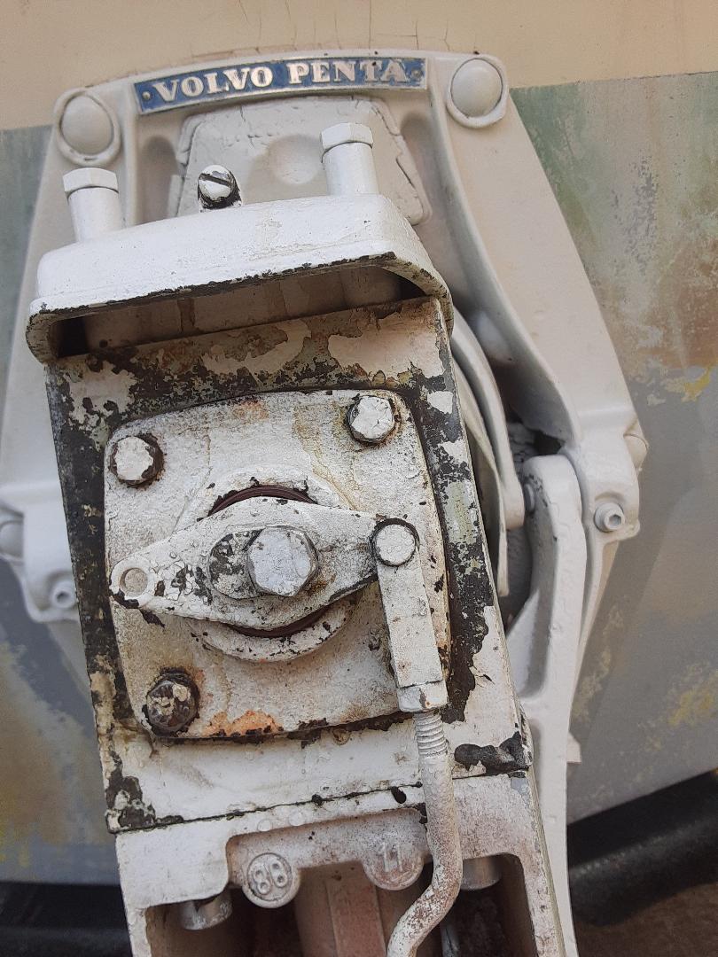

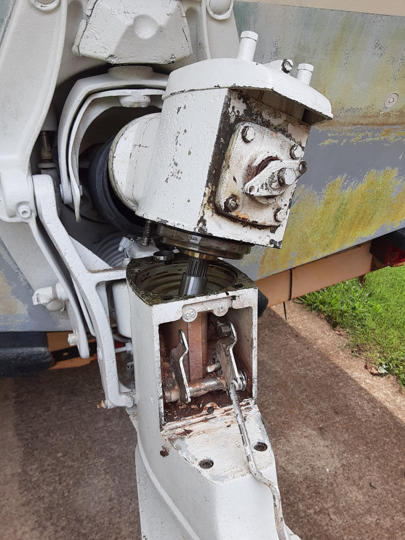

The cover on my outdrive says 250. I tried to replace that transmission with one that was sold as a 250. It didn't fit. What did fit was a trans that was sold as a 280 and yes I reshimmed it to .003 squish. Soooo, I'm guessing my outdrive is not a 250, at least the intermediate section and the trans aren't 250. Could I still have a lower 1/3 that is from a 250? Is there any way to tell?

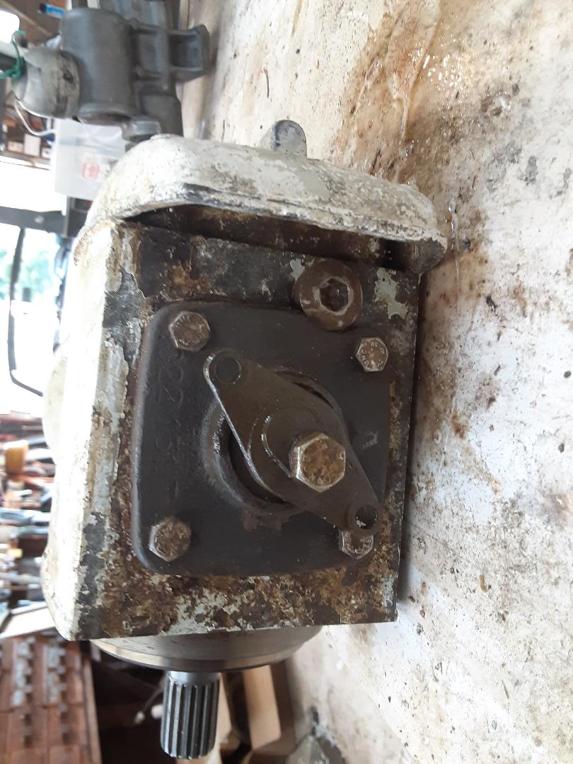

Also, the (dark) trans from the 280 which I put in, has a plug at the upper right, that the (white) one I took out doesn't have. Is there something I need to know about the plug?
I'm planning to go through the white trans to see why it's very slow getting into forward gear - reverse is OK. I've read the threads on what to look for and what 'repairs' to make.
