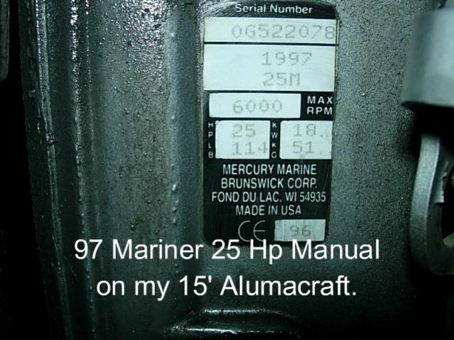

I've had this motor/boat since the year after it was purchased. About 97 or 98.

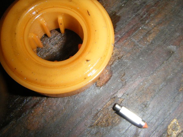

Looking at that Needle, I see the same thing B&S deals with in the newer carbs. A swollen rubber tip, sticking the needle.
Do you guys see anything I missed?

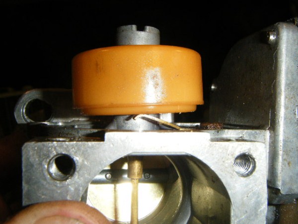

Maybe there is a little Stainless Spring wire to hold the Needle to the part that raises the needle?
