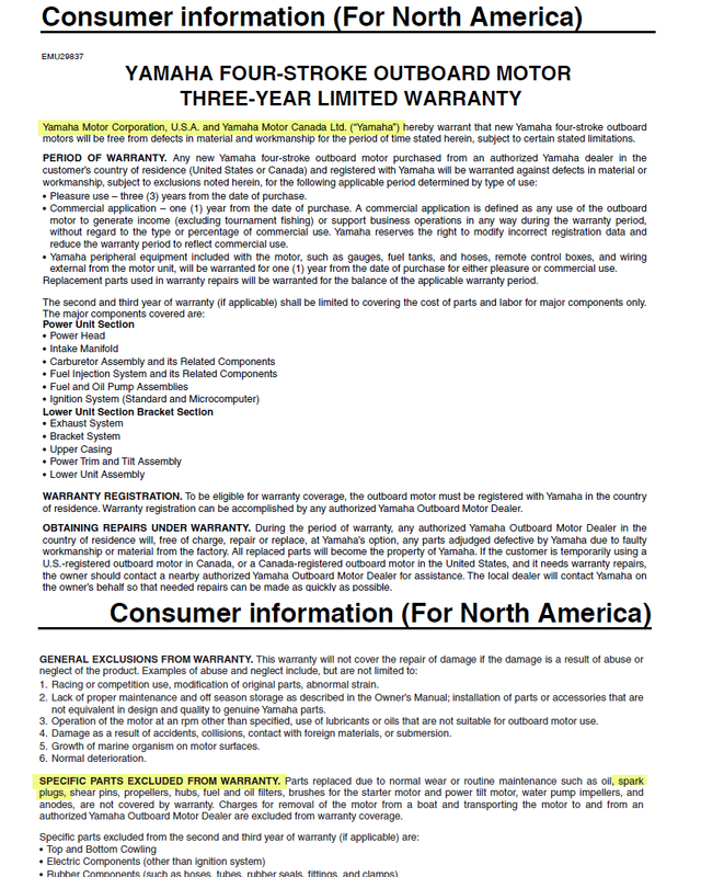

While spark plugs are not covered by the warranty my guess is that if a plug is proved to be defective on a new motor that Yamaha Canada might provide a new one on a good will basis.
Read the warranty in your owner's manual. See snippets below.
