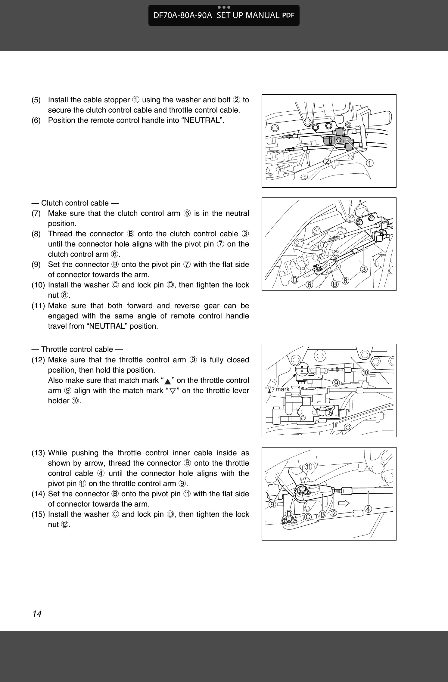

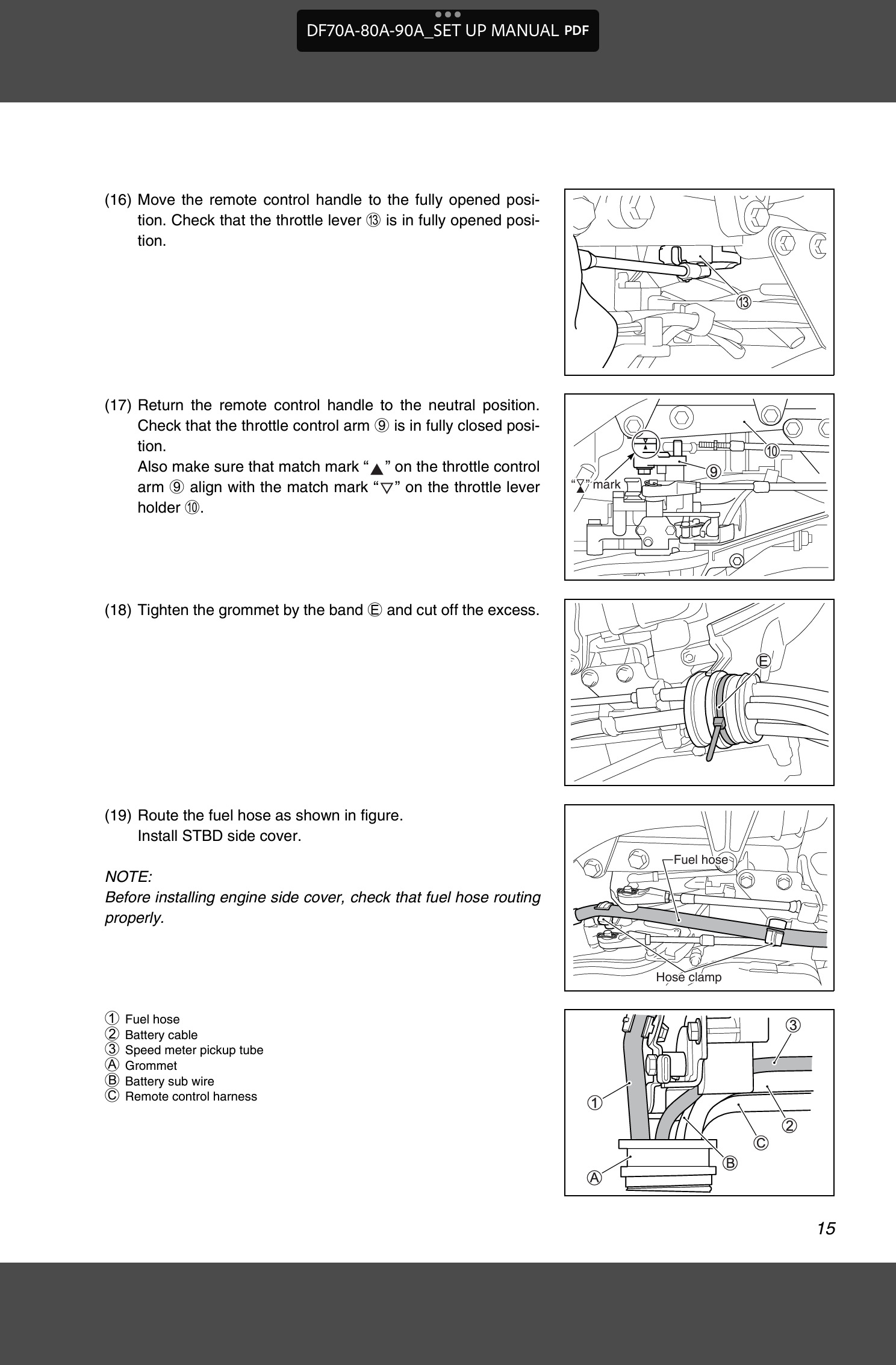

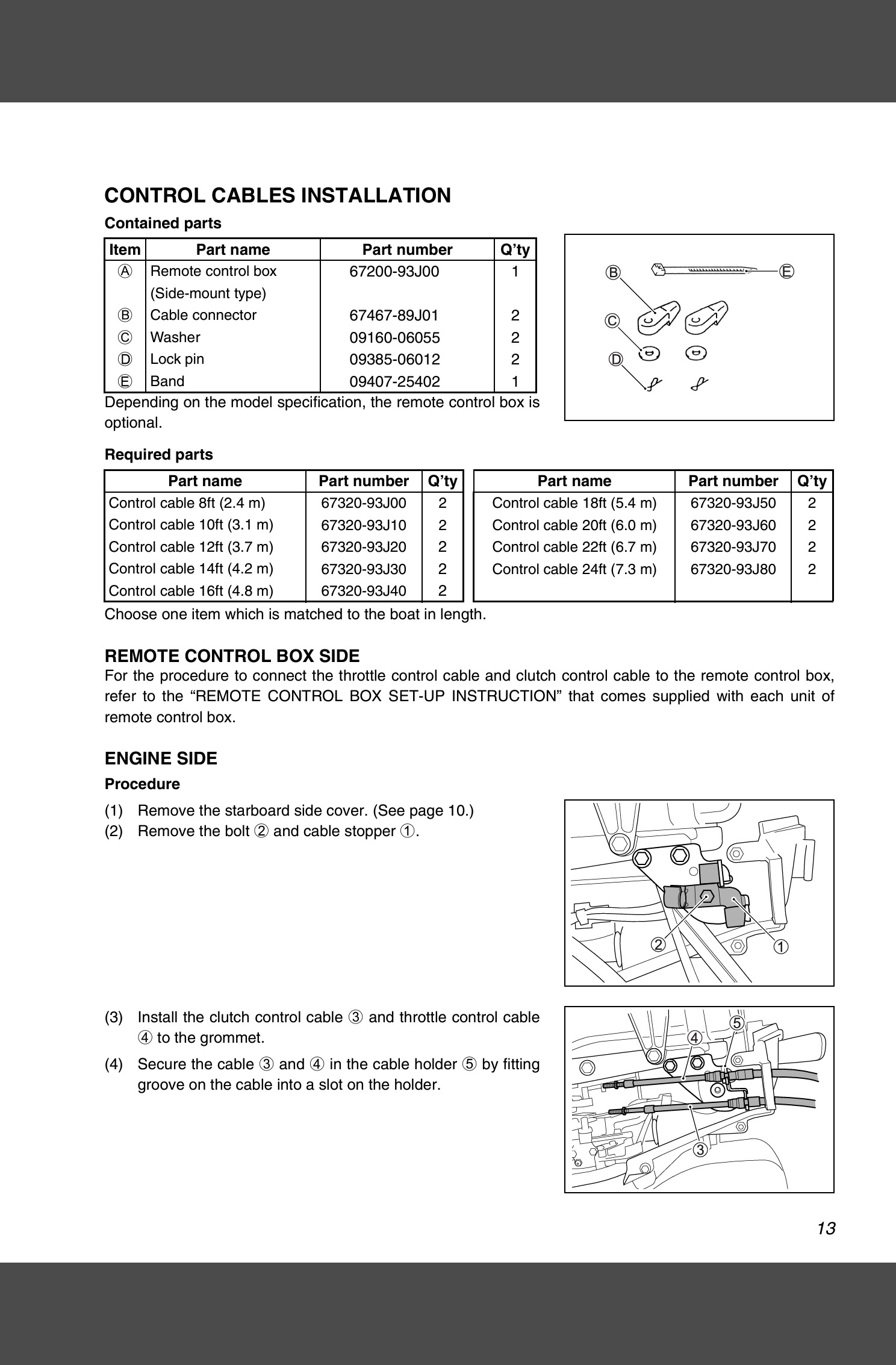

Attached are screenshots from a 2009 DF90A setup manual. It’s not your engine but it MIGHT be similar to your setup to give you an idea of whats supposed to be happening on the engine side. I wouldn’t think your cable has stretched on a 5 year old engine to the point where the throttle is only opening a little better than half way.
