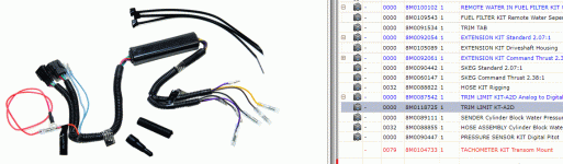

The 1.8V is coming from the Trim Limit Kit Module, Blue White wire feeding the relay (see picture) - when the up trim button is depressed the unit supplies only 1.8VDC.
Merc Part Number #8M0118725
Trim Limit Kit Analog to Digital
I think this is the bad part.
Not sure why it is necessary but it is part of the 2018 EFI 4 Stroke as an accessory.
Thanks for helping narrow down to the Blue/White Control Wire.

Here is the part: Unfortunatley $100 plus shipping.
