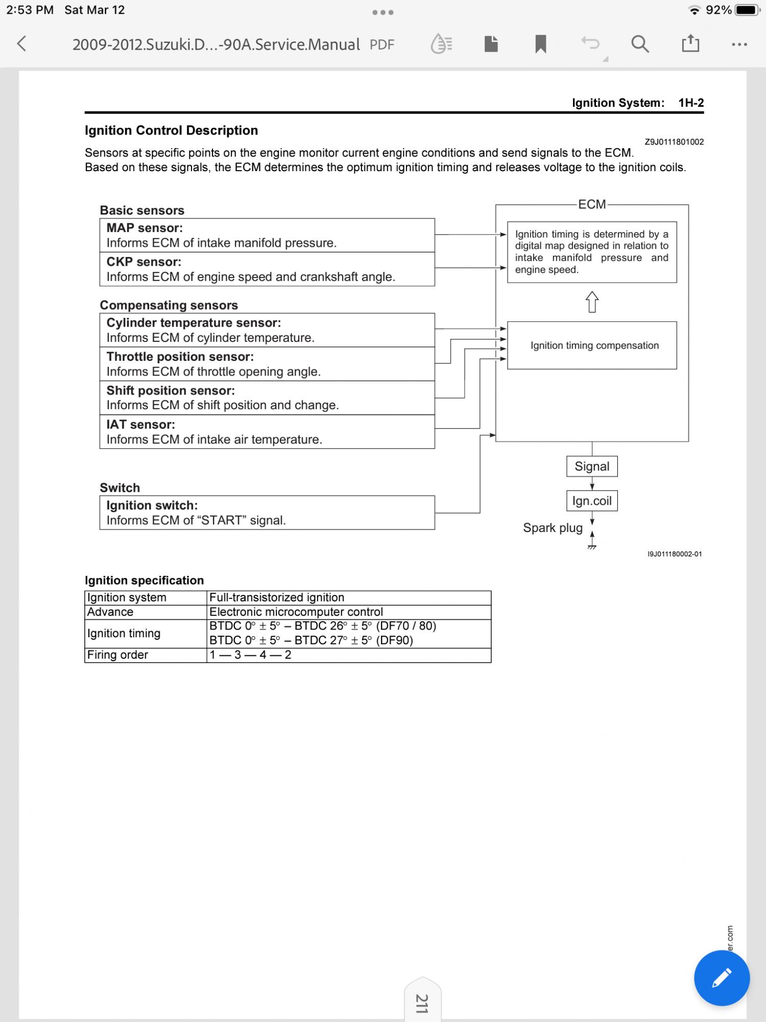

Yes pulled it and fuel is getting to the injectors. Drained it put it back together and tried to start it. Pulled the plugs and they were dry. Pulled the rail just to make sure and it was full of fuel. Is their a sensor keeping it from firing?
Hope this helps, ignition systems I’m still learning
