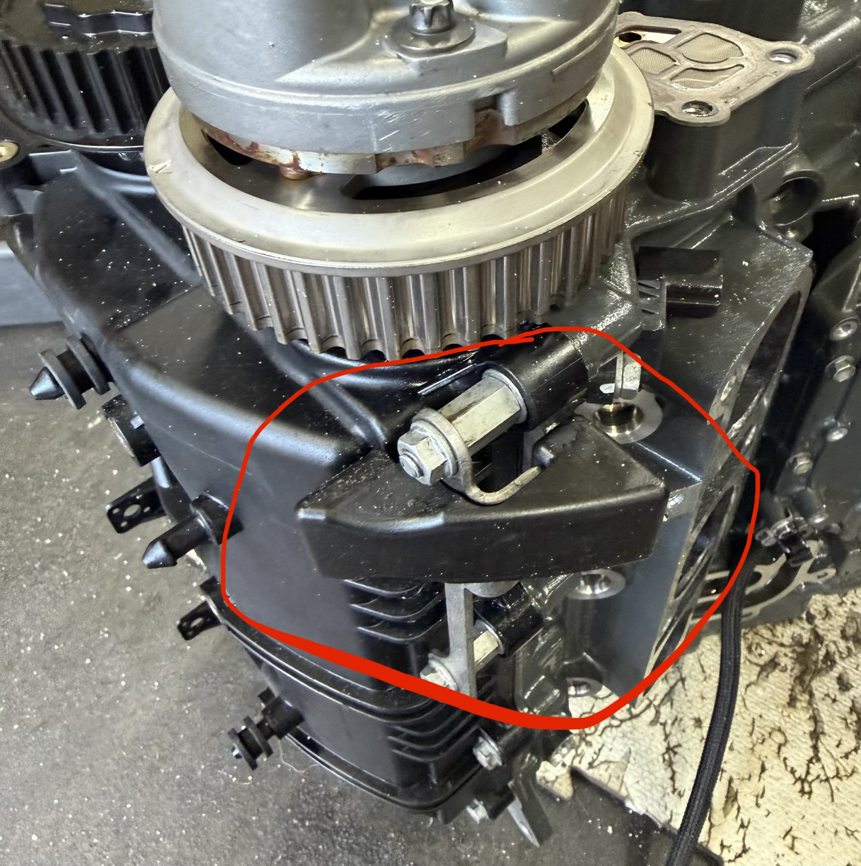

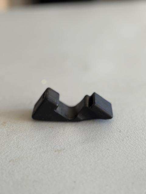

2016 Yamaha VF250xa. Removed engine cowling and found this part. Can anyone identify it?
Thanks in advance for any help!

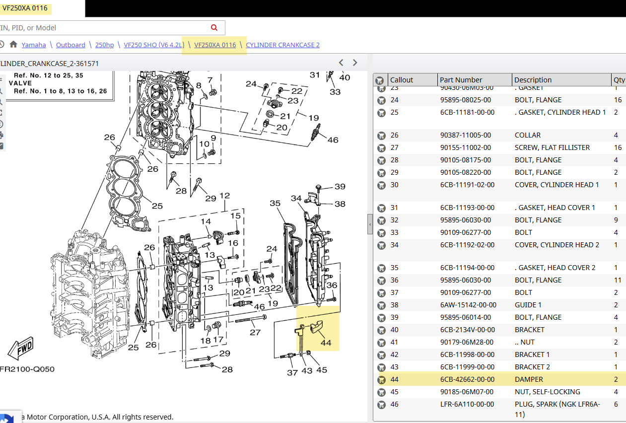

Hey My Friend,
I have attached a picture on where its located, its at the top and side of the rocker covers port and also starboard side. The picture is of my 225hp 2020, but pretty much same thing

Thanks so much for the help! Not knowing where it went was driving me nuts.
