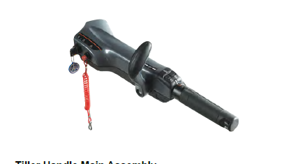

Does the tiller handle look like this?

Yes it looks like this. It has the idle adjustment on top just in front of the gear selector. Factory install when purchased. I never hear any alarms upon start up so I guess there is no alarm??? There are no LED lights showing for oil/temp alert as showing in the parts picture.
