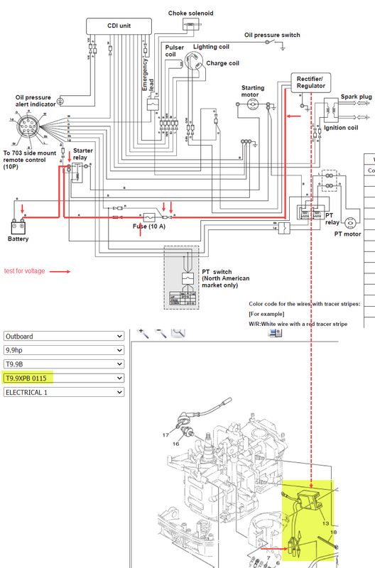

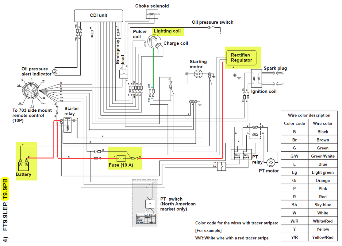

Hello im new to this forum I have a 2015 9.9 high thrust its electric start and power trim. Im using it as a kicker. This boat is new to me. It does not charge the starting battery. Anyway to have that charge it. Im worried that if i troll to long with it the electronics in the boat will discharge the battery Thanks. Paul. Any input would be great
