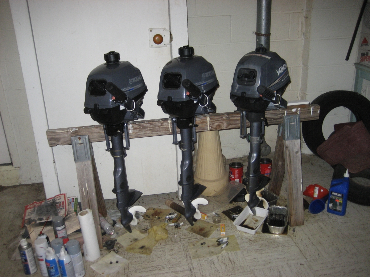

I have 3 of them. My experience is that these problems
are almost always fuel related. Good luck.
