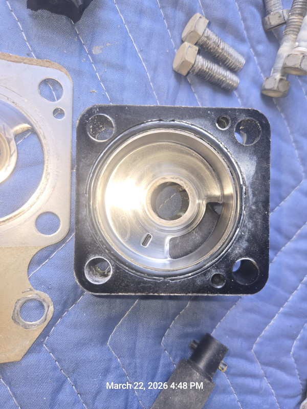

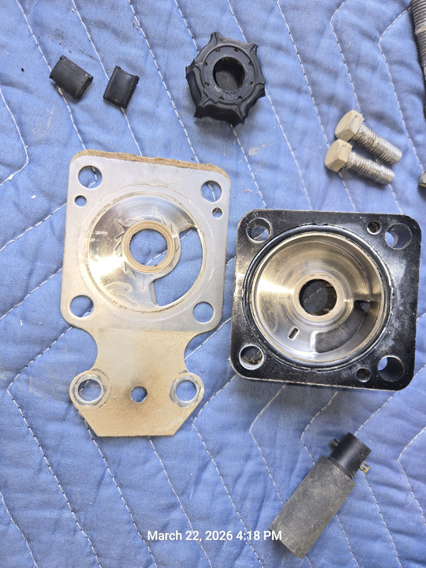

So, the good news is the motor turns over and isn't seized. The not so good is that the Impeller was disintegrated and most of the vane pieces are nowhere to be seen. Is there a way to flush out any pieces that may be in the Powerhead Cooling Passages? Also, should I replace the Housing or does it look okay to put a new Pump Cup in & reuse the Housing?
Good news it’s not seized 👍
Since the impeller broke up, you need to flush out the missing pieces—they can block cooling passages. Remove the thermostat and flush from the powerhead side by putting a hose into the thermostat housing and running water down through the block, so it pushes debris back out the water tube. You can also disconnect the water tube and flush top-down that way. Check the thermostat housing too, bits often get stuck there.
As for the pump, if the housing has any scoring or heat marks replace it. Honestly I’d just do a full water pump kit for peace of mind.

Ordered all OEM Yamaha parts - Water Pump Service Kit, sans Pump Housing, as mine looks to be in good shape, and also a new Thermostat, Seal, & Gasket. Found the other four large impeller vane pieces that were missing down behind the intake pickup screens. Will check in the Thermostat housing area for any small pieces and will flush as you suggested.
