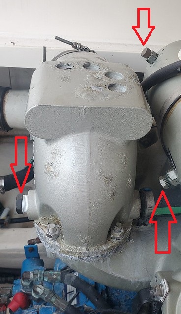

arrows indicate candidate locations...the one on the exhaust elbow may be the one you know about...hard to get the overall perspective
Thanks. Yes the top one is also an anode, looks like an E-0. No label on the heat exchanger but it is in the owner's manual. Unfortunately, they don't list the part #s in the owner's manual. I stopped by my local marine parts store (not a chain) to look for the big anode. They had some Crusader anodes in their parts inventory that looked right but are too long to fit. Hopefully the ones I ordered from boatzincs are correct.
If you think its custom, 95% of the time, you can take a standard part and cut or re-thread it to 'fit'...just get the 'correct' flavor for your environment.
