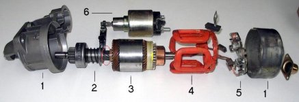

DO NOT LUBE THE BENDIX UP!!!!
you will lube up the clutch packs in the Bendix causing it to slip!!
you only repeat only lube up the shaft!!!
what i do it turn the starter bendix by hand, use a brush and paint on marine grease
its called a helix shaft
look at #2, see the the red circle, thats what u lube up, only the shaft!!
