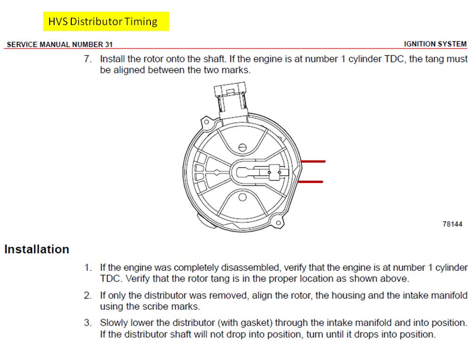

You have the HVS distributor and those caps are known to look great but be bad. Many keep a spare on hand just in case. This happened after it was serviced I would check the timing. Timing is not checked light it's visual
Can check fuel pressure and it should be 50-60 psi

Thanks Alldodge, will look into the dizzy cap for any defects, as it runs a bit rough and is backfiring at times I suspect timing myself, I don't have a timing light att, but do have the procedures to check it, the dizzy does not use vacuum for the advance, its electronic in this model, so could also be an issue there to look at for me.

On your engine, the timing is controlled by the ECU. Moving the distributor changes what is called the Cam Retard parameter and you need a scanner to set it optimally.

Never read where this is mentioned in Merc or VP manuals. Can you advise which manufactures manual this is stated?
The Delphi MEFI-5 manual is the cleanest one I've found...in the HVS ignition description section:

ok thanks, but it's not saying just how to adjust using the scanner
There is a Merc Bulletin 2011-11R2 which advises how to make a tool to get dizzy spot on, but it is done with motor OFF. Normally is only done if the regular way and motor still has issues.

I see the other issue you are getting at and dug into it a little but... lots of variables involved but the big thing is whether or not the ECU makes use of the cam position (CMP) sensor inside the HVS distributor...If the ECU uses the CMP, I think the 'cam retard' is critcal...if the ECU doesn't use the CMP, then the critical setting is the phasing between the rotor and the terminal when the spark occurs...
So if the ECU on a HVS-equipped SBC makes use of the CMP (inside the HVS) then I'm pretty sure you'll wanna use a scan tool to fine to the cam retard (cam angle) parameter.

I notice it mentions high humidity, we have Lots of that here in Queensland! But that Merc Bulletin is Very helpful! will be looking at this over the weekend on the engine as I am getting misfires.

I'll add that using cam retard with a scanner is the most precise method to set the HVS. Because that is what the ECU uses.
That said, Volvo didn't do a good job of getting the correct spec in all the manuals. It's there for some models and not for others. Also it can change from year to year, so you want to be sure you have the correct spec.
The 9 volt tool you can make (per the merc SB) always works good enough for the HVS.
