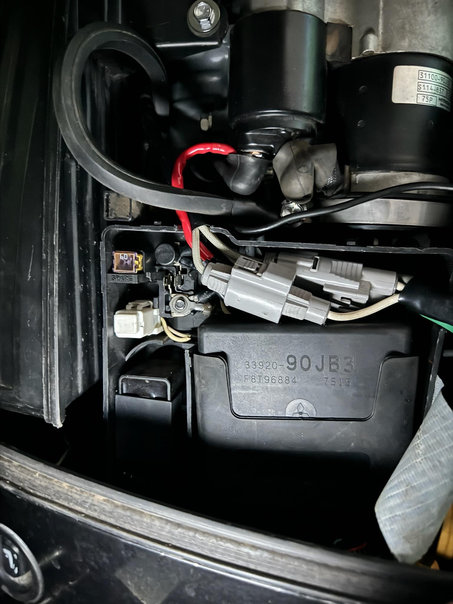

Have a 2007 DF115 with 200 hrs. Battery was low so had to jump. Ran good for an hour with no issues or lights. Check engine light came on and went off multiple times. Backed down to idle to stop and it quit. Was able to restart and get to shore to turn off. When I went restart got the 4 lights and hours check but no power. Don't hear starter or fuel pump. Took electronic cover off and noticed the terminal next to the 60 amp fuse with 2 white wires had no nut on it. Replaced the nut and tried to start. I now get the 4 lights and hours followed by a repeating single beep. Trim switch on control works but one on motor does not. Checked the 15 amp white wire fuse and it is good. Moved in and out of gear thinking neutral switch. Checked the 30 amp and 60 amp fuses and they are good. Any ideas?
Here is image of terminal missing nut

Charge your battery and load test it. When running measure your battery voltage, should be around 14 volts. There is another neutral safety switch on the engine, it could be acting up. Look where your shift cable terminates on the shift shaft and give it a wiggle. Kill switch will also give you a no start as you described.
