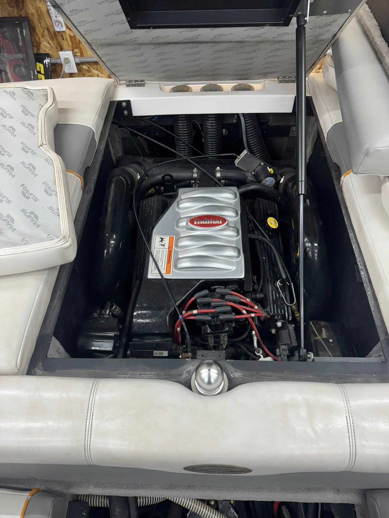

Show your engine, its model and serial number (should be on a sticker, on the oil pan).
MEFI 3 & 4 were long gone by 2006 at Indmar, AFAIK.
Why did you need to replace the distributor?
This is the only picture I have of the boat currently. It’s raining today so I can get more if yould like. I went through and did a standard tune up and when taking the rotor off the reluctor was pretty loose. It received new plugs, wires, distributor, fuel filter and all fluids changed. Put a new impeller in it as well and
